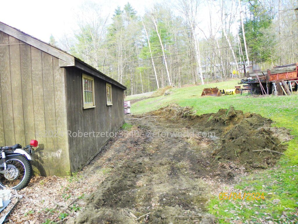

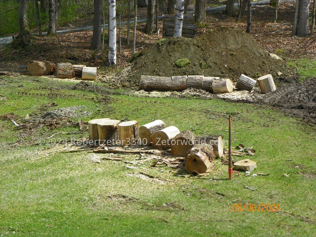

Using the loader on the Zetor 3340 to dig beside garage so to have a flatter area.
Need to re-shingle the garage roof.

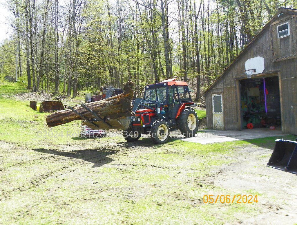

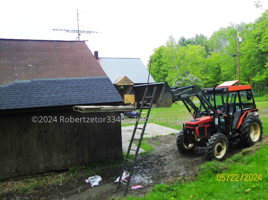

Have a set of Vevor-Pallet-Forks (4000 lb version) helping cut firewood and move pallet of new shingles.

Your Quicke doesnt have Euro standard quick attach ? Youre loosing a lot of force when the bucket remains between the loader and the forks..
Hi Renze, Yes, I was not able to lift the whole tree up,
but the whole tree was very heavy.
I have not tied the quick attach part yet.
I did see where I can change the up and down cylinders to have better leverage,
which should increase the lifting power.

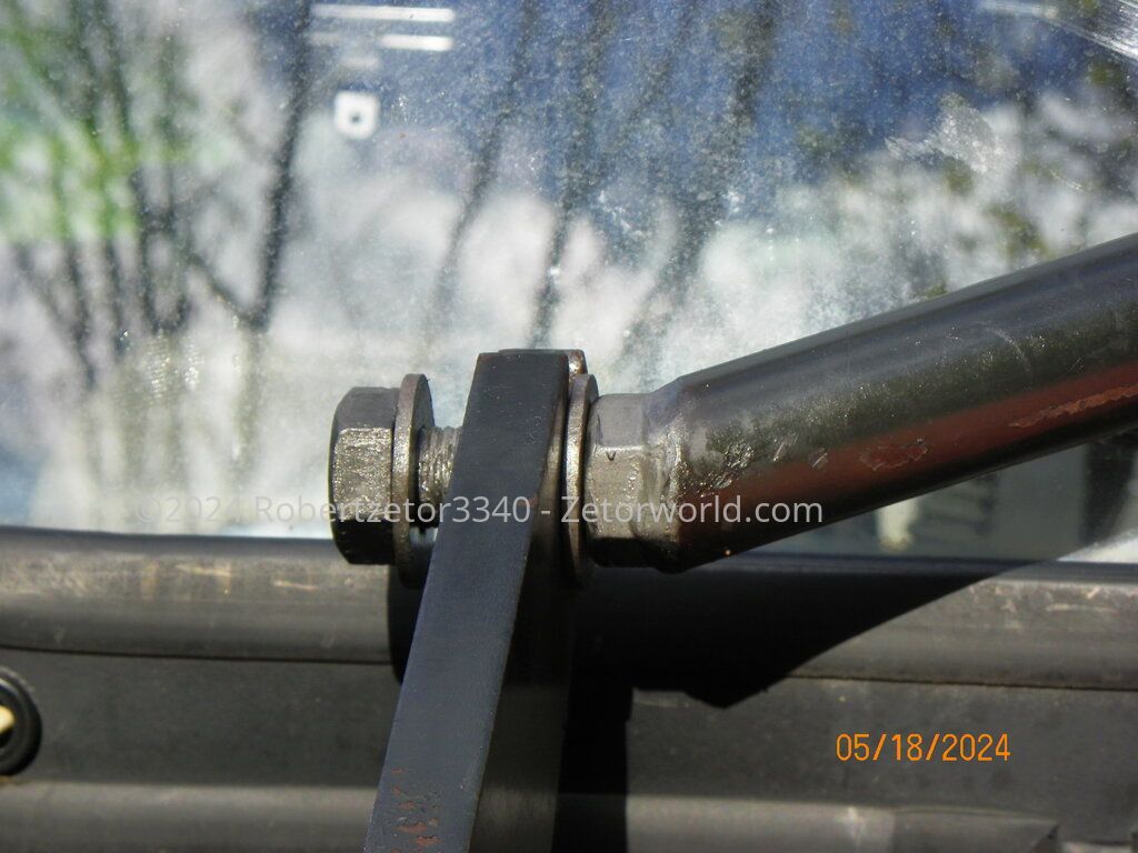

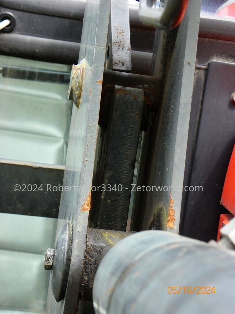

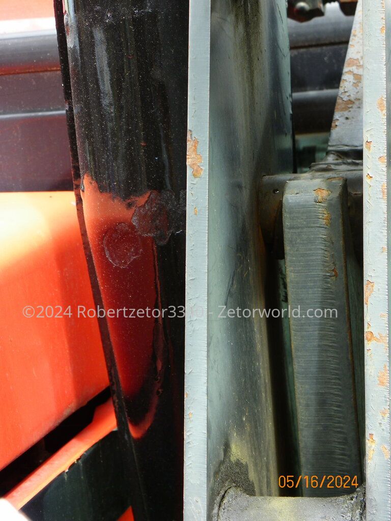

I tried to detach the Quicke Q720 loader and I was not successful.
I tried different positions with the two angle supports and was not able to lift the loader up from its mounts.
I am not understanding the process, as I have not been able to find any info on how this is done.

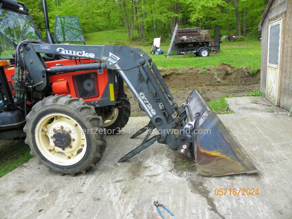

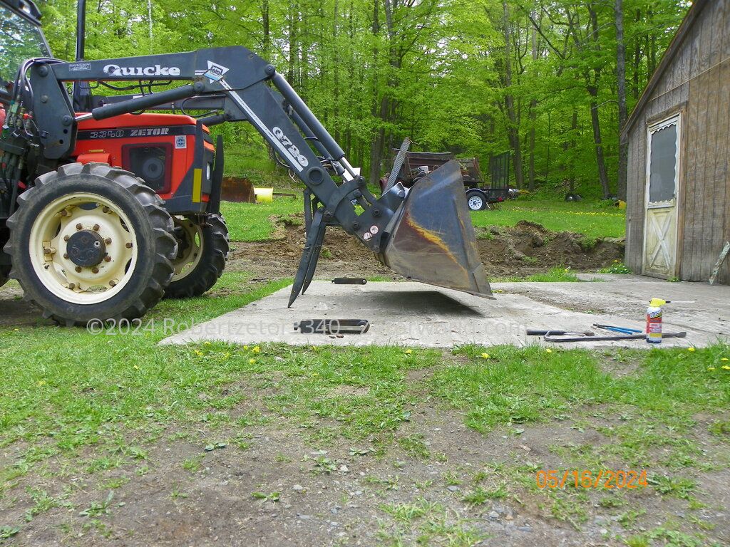

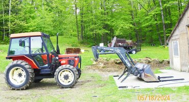

I got the Quicke Q720 loader detach today.
Needed to use a short bar to help lift the loader up out of pin-cups.
I believe there is a twist in the loader frame which may have been holding it in place,
because the loader did moved over to one side when it moved up and out.
Or maybe it could be the ground surface needs to be very flat.
