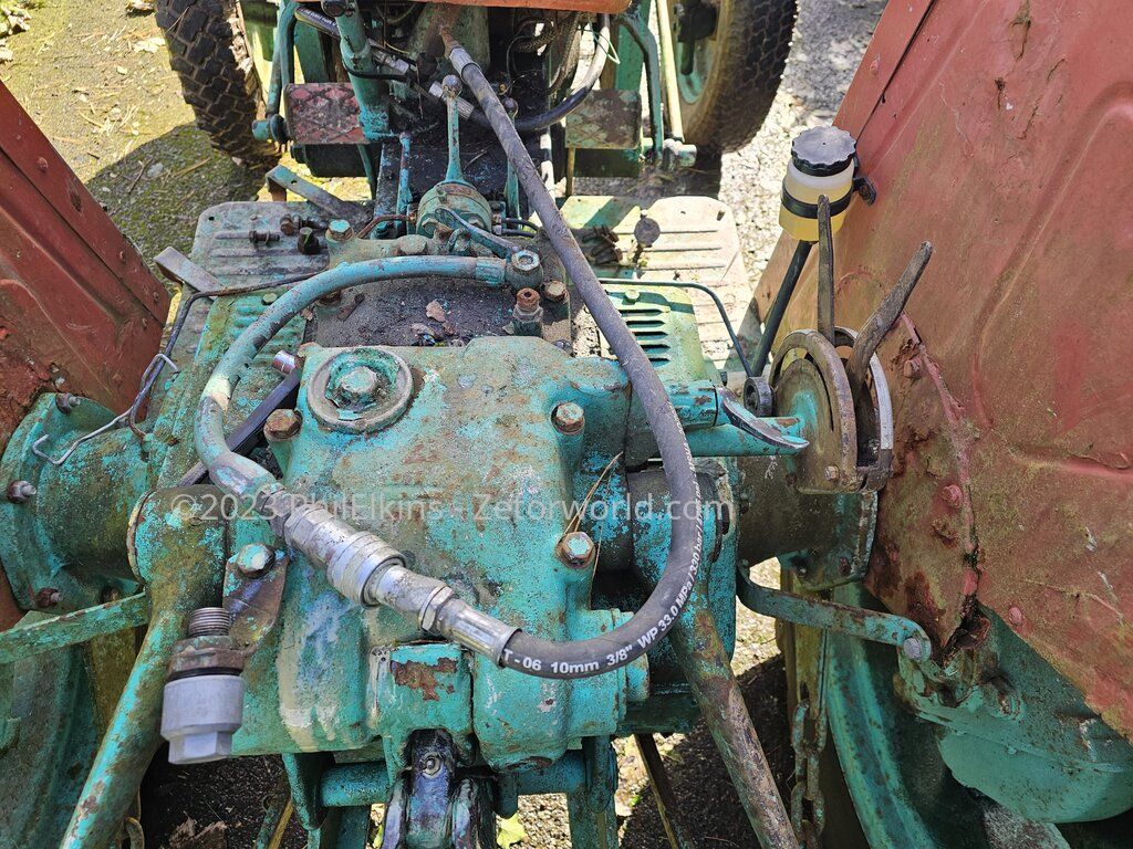

So this is the current setup. Inner arm controls loader and works fine, outer arm controls 3 point linkage and no movement at all. Really not sure what to do next.
Hydraulic fluid in picture is only from me disattaching loader to see if it made a difference. It didn't!

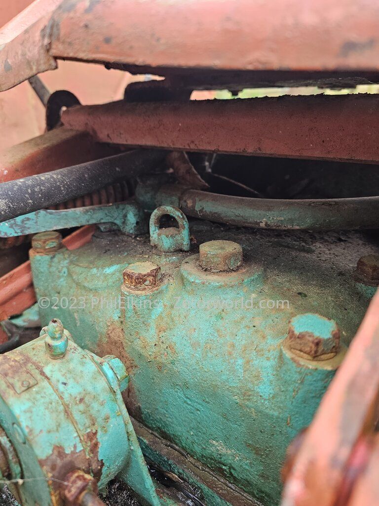

All sorted. There was a valve at the back of the pump that was stuck closed. WD40 and moved it now working fine.
(This isn't my one - it is a photo a friend of a friend sent me to show me where his went wrong!)
