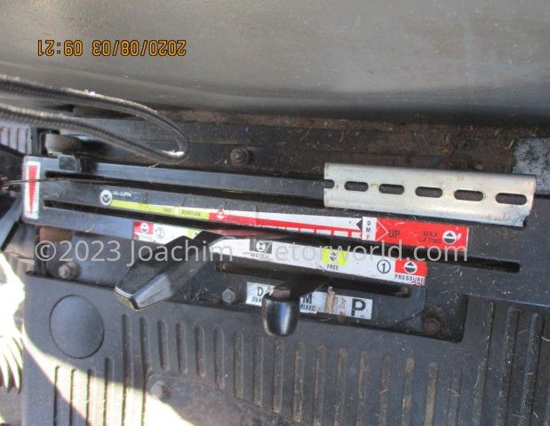

Have a problem now with it lifted for transporting and it suddenly drops and then goes up and down violently. The Mode selection lever is set to M, I assume that is correct. Have checked transmission oil level.
Why is it doing this, is there somthing wrong with the tractor hydraulics. never had that with the other topper.
Thanks David
Put the hydraulic lever in P position, if it keeps dropping and lifting by itself you could have a leak in the lift cylinder and has only shown up from the heavier weight.
If the lift is constantly going down and re-lifting by itself when you weight on the lift, the rings in the lift cylinder need replacing which is under the lift cover, under the floor behind the seat.
Thanks
The lever for lifting has marked UP, DOWN, POSITION, FREE, MAX DEPTH, where should it be when topping? I have been moving right forwards to MAX DEPTH.
