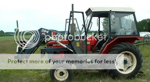

I have a 5211 and all the manuals for it but knowwhere does it show a red push/pull button.. Are you sure its not something the previous owner may have installed? I paid $7000 for mine and it had over 2000 hours on it but it also has a Allied front loader installed. I would think $6000$7000 US sounds about right with no loader, age and hours.. By the way, I live in northern Michigan.

The loader works great for light duty work but not for earth moving. Keep in mind this is a farm tractor not a landscape tractor. Your tractor, with less than 500hours is just getting broken in. In my opinion, A Zetor is a very under rated tractor. They are very reliable and you would have to spend twice as much to repalce it with a more well know name such as a JD, Kabota, MF, etc... You can easily get parts for it too. I believe the loader runs around $2500 but I'm not sure (call Allied), mine came with it already installed..
Here a picture
http://img.photobucket.com/albums/v356/hoosier12345/tractor.jpg

The picture I posted shows it with a spear but I have since put a bucket on it.. My tractor looks much nicer now, the picture was the add from where I bought it from and it needed alot of TLC to get it looking great again. My hydraulics cant lift a full bucket of soil, hence the reason I said it wouldnt be a great landscape tractor (that and the AG tires Other than that, it works great.
