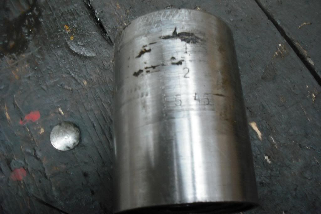

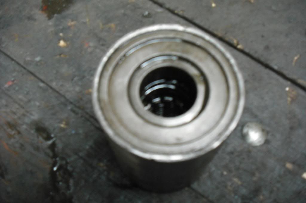

I finally got around to doin a bit with my 5545 front axle. When I turned the propshaft there was nothing happening with the front wheels so after a bit of stripping this seems to be the problem.
Does anyone know what this is? I presume its some type of clutch to allow for difference in speed between front and rear axles?
It could be a freewheel clutch or something. Must read through parts manual first, but i dont have time these days...
I think it must be a torque limiting clutch, I don't remember seeing one before, but its over 40 years since we had a 5545 so....
Dave you are right it is a torque limiting clutch to protect the half shafts in the front axle
Thanks for the replys. I wonder can it be rebuilt? It would be possible to convert the axle to work without it id say but I wonder would it be ok.
