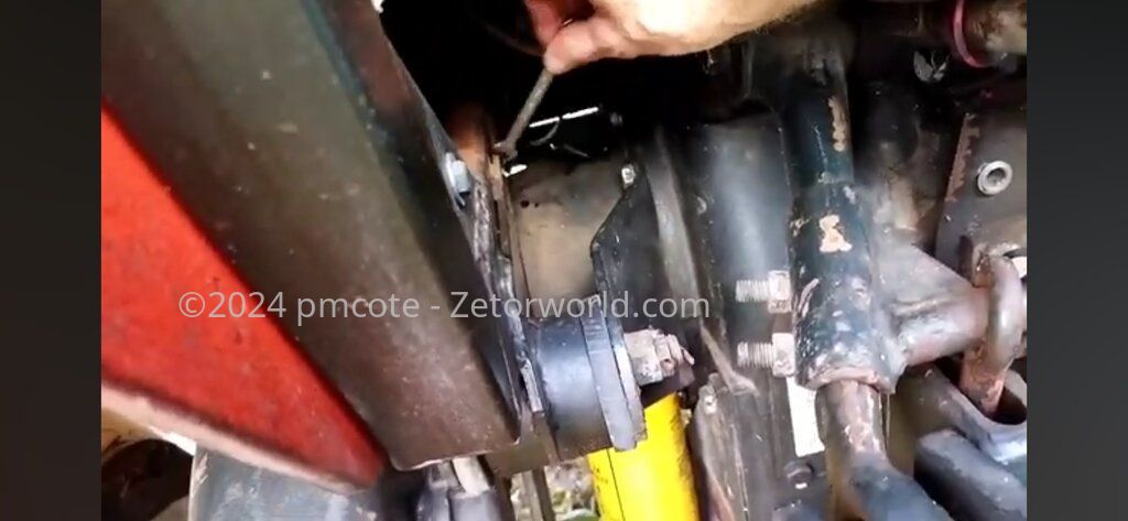

Hi folks, Im trying to find the brake bleeding screws. According to this picture its supposed to sit on top of the frame/brake frame. I cant find it at all arround here. Can anyone advise of a picture or way to locate.
7745 1990.
Thank you
Wow - you have the first 7745 I saw without disc brakes...
Its easy - just go with the brake pipe to the axle(s). Its end in the wheel brake cylinder(s). Near by this, the brake bleeding screws do you can find.
