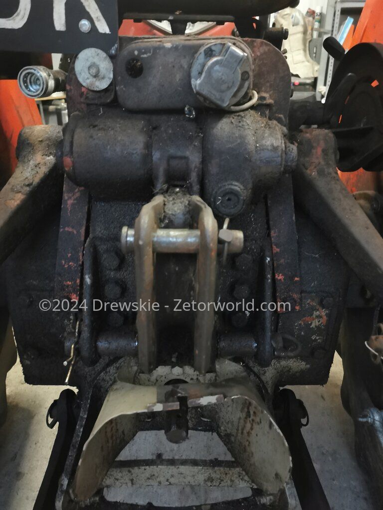

Hello Andrew,
do you have one or two external hydraulic ports mounted?
every Zetor have a double working hydraulic valve, but not all have mounted both pipes for. A Picture from behind the tractor can help .

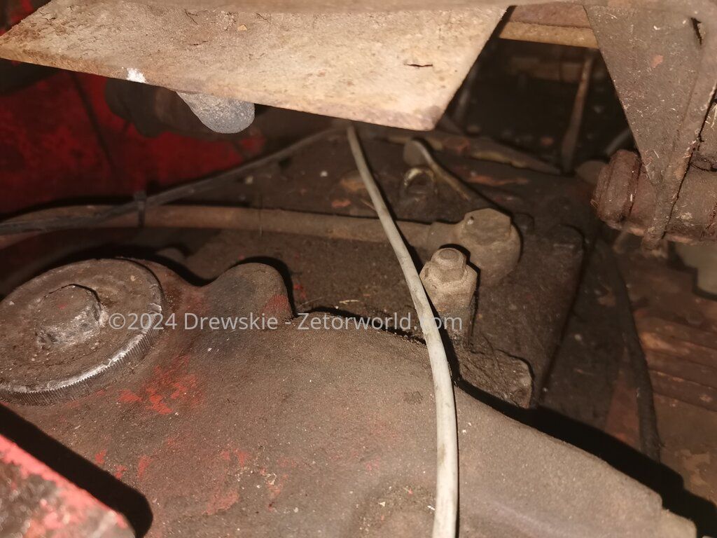

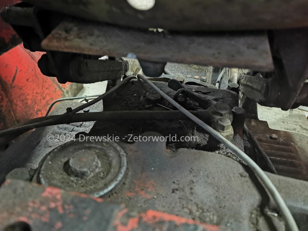

Hi,
It has one external hydraulic port.
I have taken a few pictures of the back and underneath the seat
Perfect! Thankyou.
So just to clarify that I'm safe to understand do the bolt and theirs nothing it's holding inside?
Appreciate you help ☺️
Just take a look at spare parts book:
hold the 39 and unscrew the 60... dont unscrew the 39 !!
then buy a new screw 8 and a new coper seal 10 and mount it with a new hydraulic pipe and hydraulic port as you need it.
