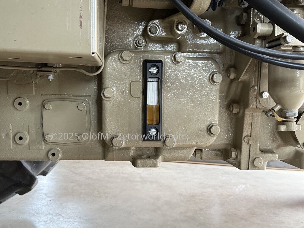

When I upgraded the gear box to 35 kph by changing some gear-wheel, I had to cut off the oil-dipstick sinse it touched a gear-wheel.
This made it impossible to check the oil-level. So I got a level-glass and mounted it on the right side-lid of the gear-box, but first had
to mill the lid to make the surface smooth.
IMG_5095.jpegA photo to explain:
