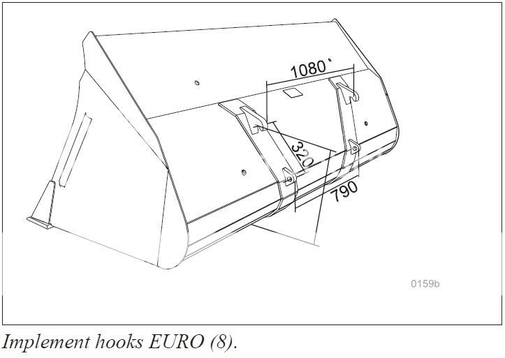

Hi All,
For those that may be interested, I have finally found the euro 8 coupler dimensions. I hope this may help somebody one day ;) Now to drag the welder out and make some sparks!
The 1080 dimension is pointed at the inside of the hooks, but it should be over the outside of the hooks ;)
Hi All,
The 320mm measurement on that picture, is it from the center of the locking pin hole to the top of the hook?
