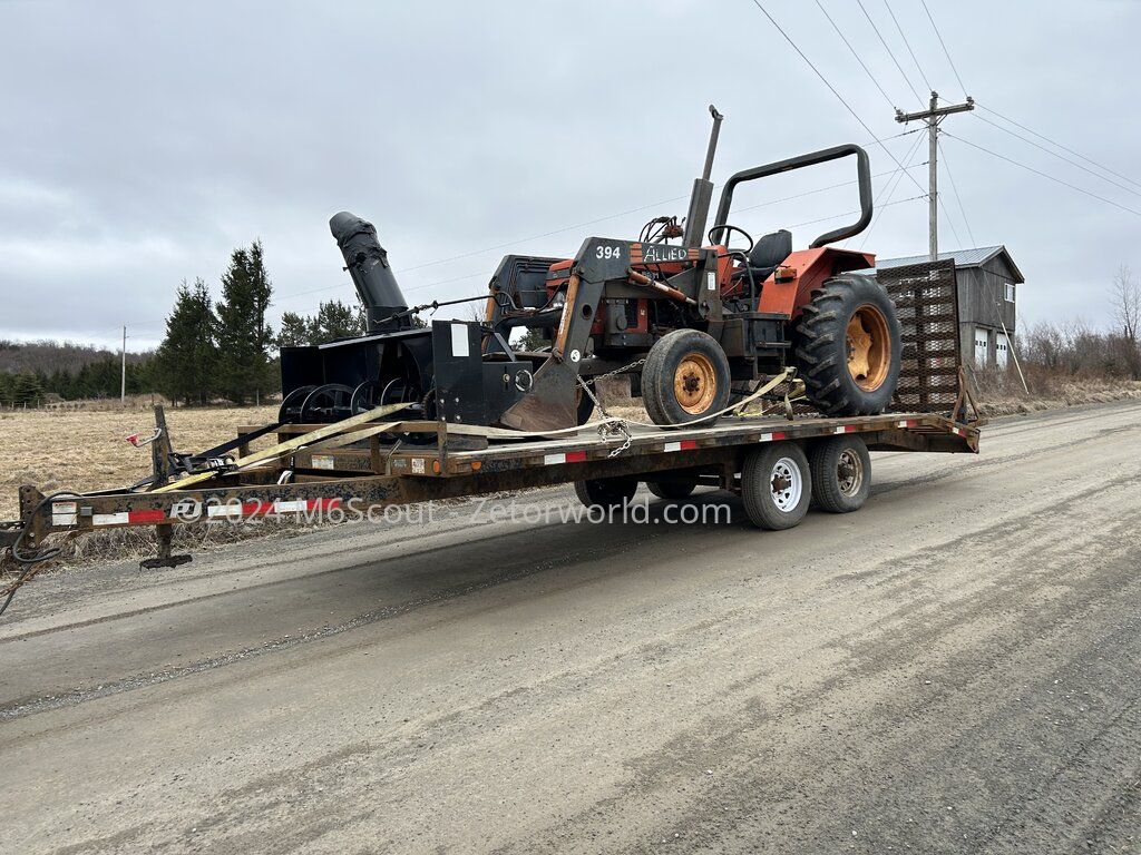

hello Hi this is my Zetor 5211 tractor- my name is Mike
M6Scout
Mar 6, 2024
9
USA
Bob
5211 2wd with loader
Hello.
I’m new here and just purchased my friends 5211, it’s having trouble lifting rear arms more than a foot. Bucket and pto work fine any suggestions would be greatly appreciated
