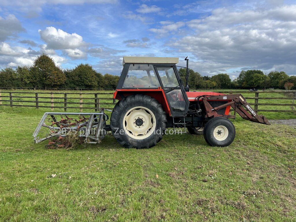

my Zettor is running low or feels like its running low on steering oil ,but i cant find where to top it up ,any ideas?

Thanks Joachim, Yes there a tank for power steering oil on the right side of the engine, just in front on engine oil filter. It's a rectangle shape and has a 30mm nut on the top. And a big pipe on the bottom going back to the power steering pump in the bell housing. I have circled your picture. That's a good looking 8111 there Phil. I have 2 of them myself. I also sell and dismantle Zetors parts. if you need any bits.

Forgot to add, be sure to change the filter too. They were often never changed by farmers. And also you have the wider wheels on the front, can make steering heavier
