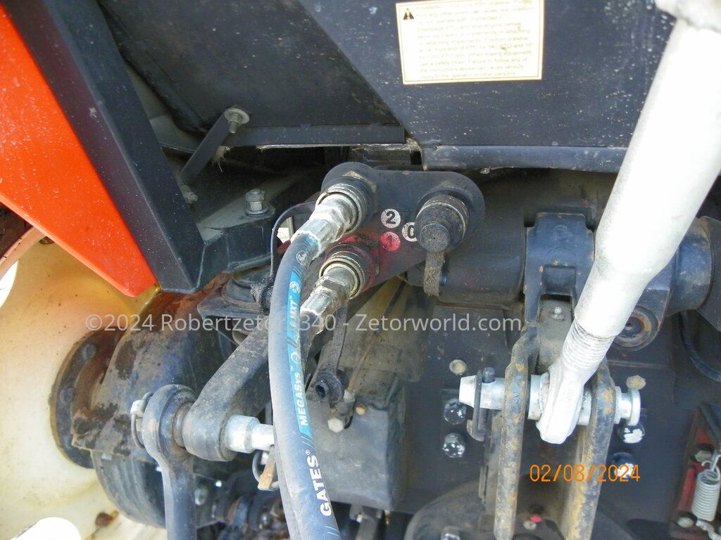

The connection may be different between them, but does it look like this ?

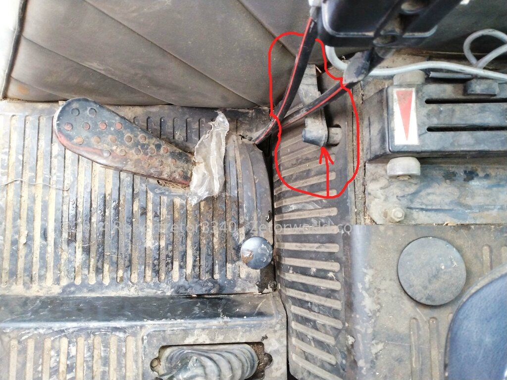

The Flip-Lever should control the oil flow speed.
This have nothing to do with the external hydraulic connectors. ;)
That works only for the internal hydraulic for the rear lift arms.
The flip-lever is called reaction speed lever and that means the oil flow setting for your lift arms.
