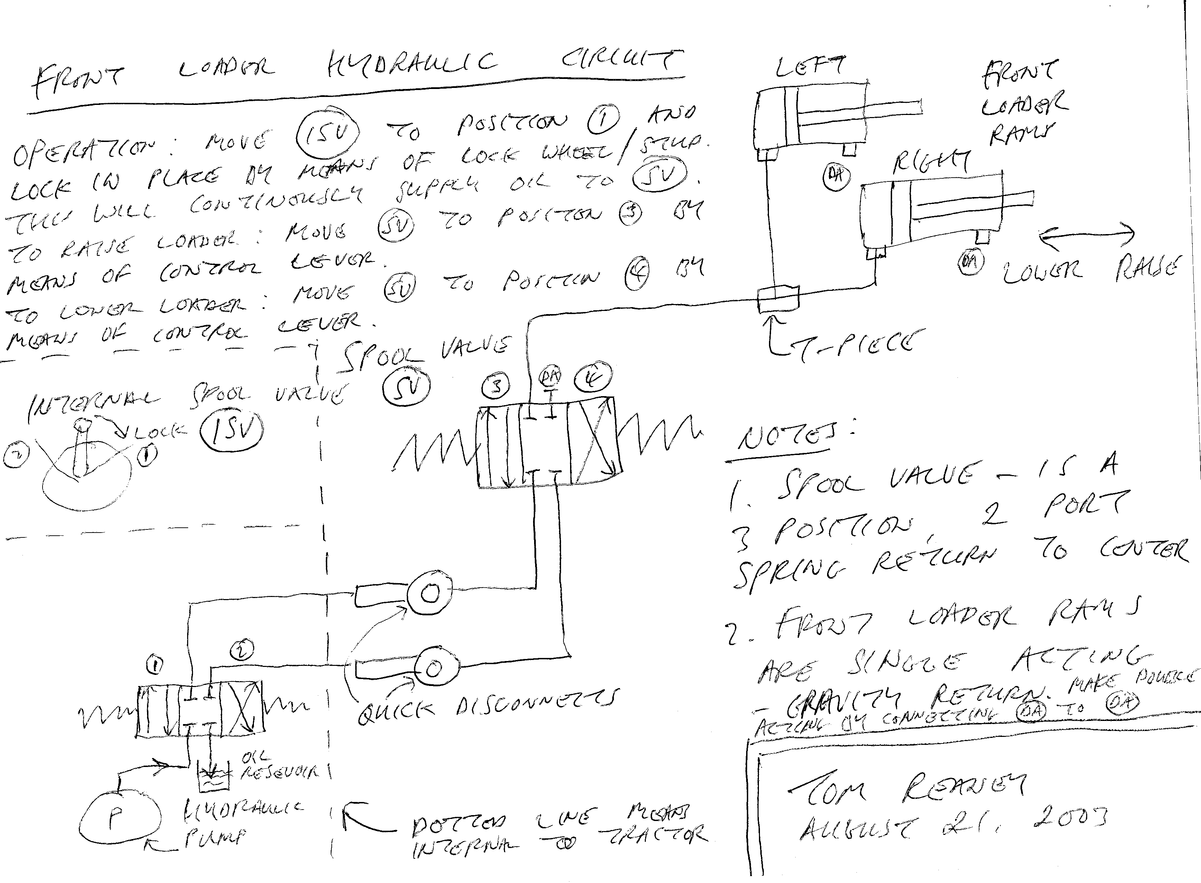

Yes, it sounds complicated, but I bet I can figure it out. Do you have a simple schematic or a hand-drawn sketch you might be able to paste here? I know I could check it out if you could possibly do that.
Thanks.
Hi Big Orn,
I can sketch out a schematic but will not be able to post it on the Zetorworld forum. Renze - can you help here?
Send me an e-mail at treaney@iol.ie and I'll e-mail it to you.
Tom

I have posted a scanned in image of a hand drawn schematic of a hydraulic circuit for a front loader to:
Tom in Ireland
That is just what I needed. It looks like the servicemen who installed my Loader did not??? hook it up directly to my pump, but instead by-passed the circuit which allows the Loader to be the primary receiver. Now I have to go into the rear housing and hook it up direct!!! Thanks for your sketch, Tom!!!

Yes, but that connection sends the hydraulic fluid to the Loader first - before the 3 point hookup. My pump is in the rear housing - I guess, because I can't see one outside the tractor, on the motor. Under my seat there are two steel lines coming from the housing that goes to the remote. Keep in mind that the manual I bought was not dedicated to the 5211. It does have portions in it that can help , but not enough detail. So I am basically shooting in the dark as how to plumb the loader and lift as one unit. I would really like to have an exploded view of the hydraulics and components. Your sketch was enough to let me know why my lift was starving, now it's my turn to figure it out.
When we fitted our loader on our Ursus C-385 A first, we had a similar problem with the hitch.
Then we figured out that the system had two return lines, one for oil overflow when no pressure is needed and the oil flows back to the reservoir and one pressureless return for oil that returns from the cylinder when you move it up or down.
The oil from the first mentioned line should flow through the hitch valve block too.
My neighbor, and on our own loader, we use one line from the external hydraulics at the back to feed the loader, so we never get trouble. However plumbing the loader directly to the pressure line before the other valve blocks would be a nicer solution, you keep your external remote free for other uses.
So, you cant make a split off of the oil lines, they have to be plumbed in series, not parallel.
