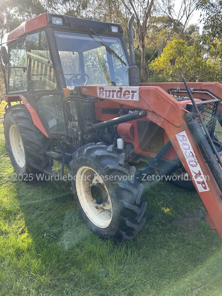

Hi Everyone
l picked this tractor up
off my neighbour when
he moved back into
town.
Pretty happy with it., specially being a tractor with a cabin.
The throttle seems to slowly move from medium revs to low (or stalls)
Any suggestions?
Can it be tightened up?
cheers
Paul
Hello and welcome Paul! :)
Yes, just sscrew up a littkle bit the screw at the middle axis of hand throttle in your cabin.
But that only works if the brake plates and spring there are all OK.
