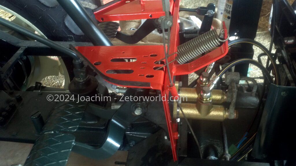

I loosend the brake band was hoping that it's going to free itself on its own once it starts moving it haven't found a master cylinder for the brake yet only the clutch it's the older model zetter
The master cylinders are located behind the brake pedals. You can unmount the brake pedal plate and move it in the cab a litle bit. Just demont the brake pedal cables bevor you do that.
