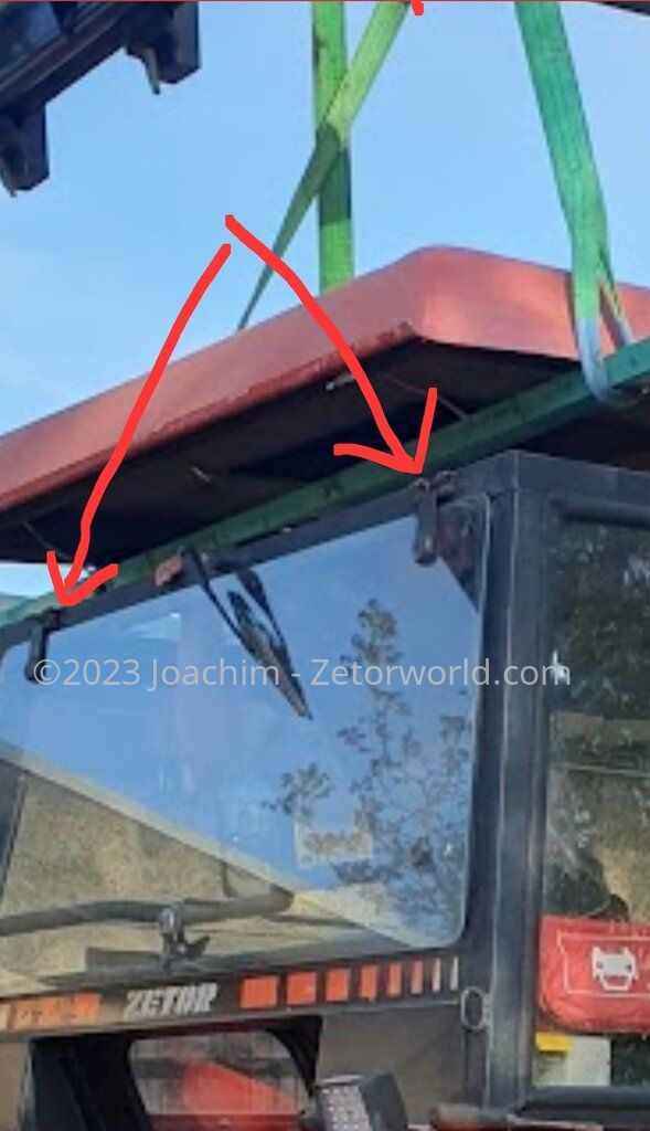

Hello all. I need to remove the fibreglass top of my 5211 cab. There are 2 obvious bolts on the front but nothing obvious on the rear. Has anybody removed a fibreglass roof and is it easy enough to do.

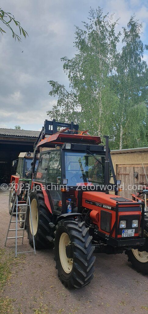

Hello,
You have to bend the hinges at the back slightly, then, if necessary, disconnect the cable for the rear window wiper and you can then lift the roof out of the hinges at the back. :)
There are 5 screws at the top. 3 from above and one from each side. They all have to go too.
