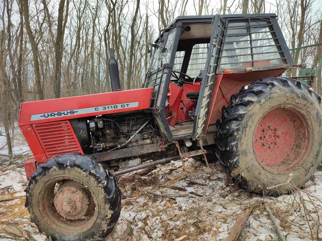

Please help .I heave Ursus c3310dt and i heave problem with pto and torque when going uphill.Oil level is ok +5 cm over dipstick mark, filers ok, oil clean.When going downhill everything is normal, all work-s fine.what should i do?Thank's

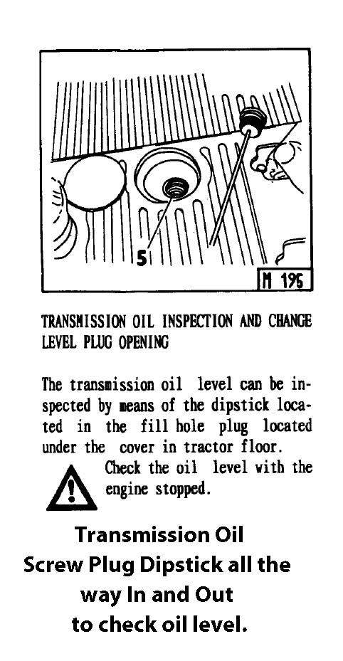

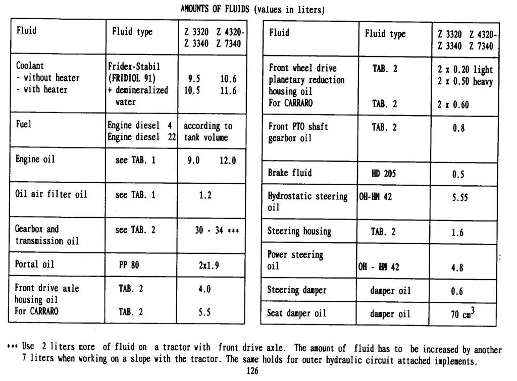

At the bottom of this chart it notes adding more oil when working on a slope.
