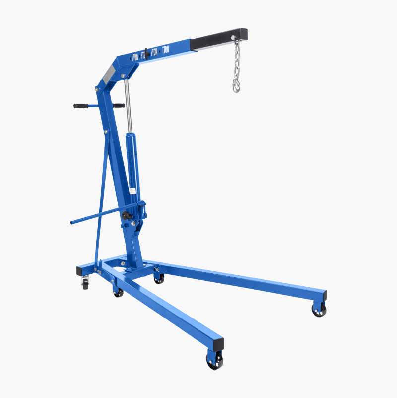

I was originally planning to park under a roof and use some lifting device from the roof but I see that mudguards and other things need to be removed. This crane may be useful
Similar to the one Renze linked to. Lifing up to 2000 kg and cost NOK 2000 which is something like EURO 250

Started the job yesterday evening. After slightly more than one hour, I needed the crane (bought the one I linked to) and started unpacking it. Lots of parts were missing, there have to be two boxes and I only got one... All bolts, wheels and some other parts were missing...

You paid 250 euro, only the colour is blue instead of red like mine... it seems i DID get a steal deal on it ;)
I checked lately but the wholesaler i bought it, stopped selling this line of chinese tools, to i think i got a special clearance price:)
The crane took the better part of an hour to assemble and is very useful for the brake job.
