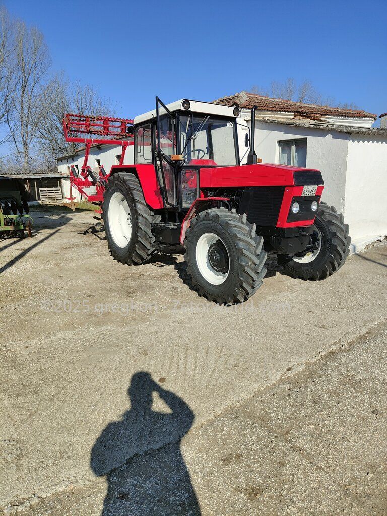

Hello everyone one! I have a zetor 12245 I want to install air condition system does anyone can help me what is the best vfm. System kit ? From Europe or AliExpress or zetor system . And I want to install Grammer seat what type of those is the same height? Iam interesting to install diy suspension cab system any opinions?

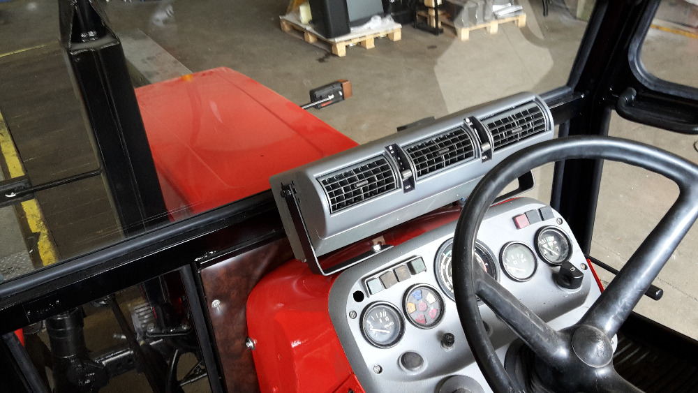

One idea is to install a bigger alternator, and to fix a set like this
on the roof (the compressor needs AMPS, so tou need heavy cables. But it's easier that plumbing i think?).
Here is a design picture (from a finnish web forum), the plate is the roof hatch.

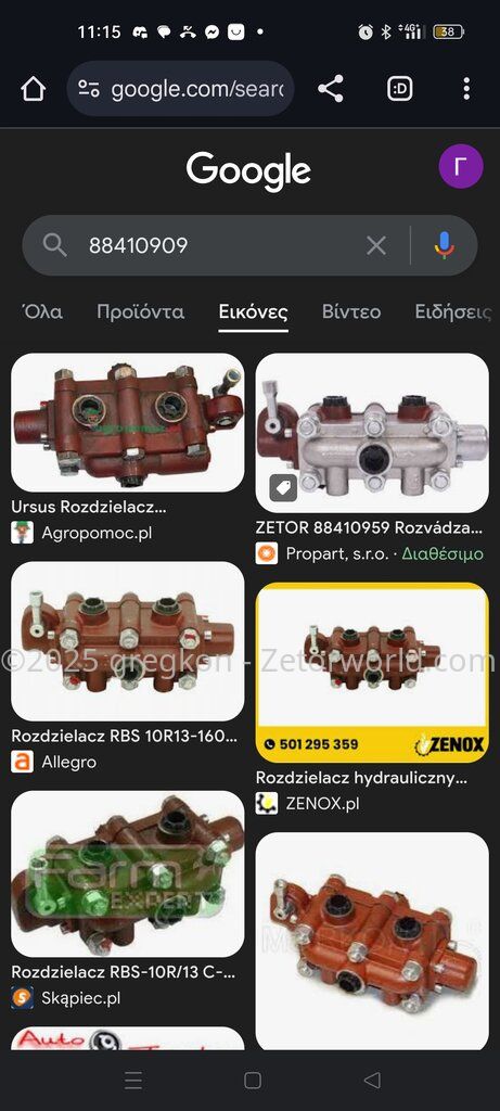

Thanks but I don't want at the roof one zetor has aftermarket kit but I dot now we're buy it ... We're can I find original parts for zetor 12245 ? At cz or Slovakia? Original for hydraulics etc not aftermarket
You can just use the Google search by "Zetor xxx" (xxx will be the spare parts number you need) to find your needed parts.
You can then only ask if they ship also to Greece... Signs for original pars are the one signed with "CZ" or "SK" or "Zetor original". Or ask your lokal Zetor dealer.
Local dealer sell junk parts no quality
The local official Zetor dealer? :eek:
Well, you can never be 100% safe from bad parts, it can happen to you at any dealer, but it shouldn't be the rule. ;)
Try Nekvinda (CZ) or Marting (SK) - both long-established suppliers, quality is usually OK.
Ask him directly via WhatsApp or mail - If original parts existing, he can help you. Same at the other one. :)
