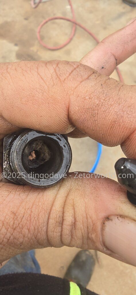

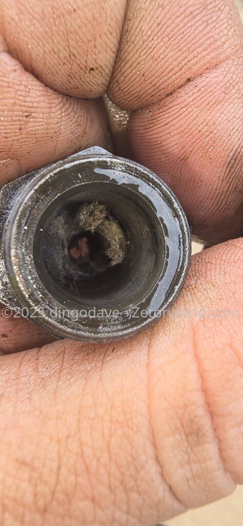

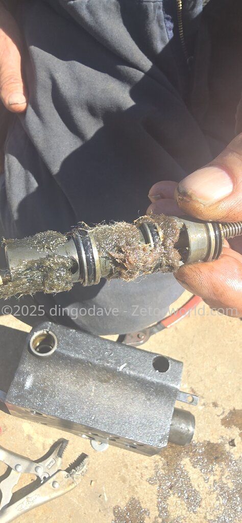

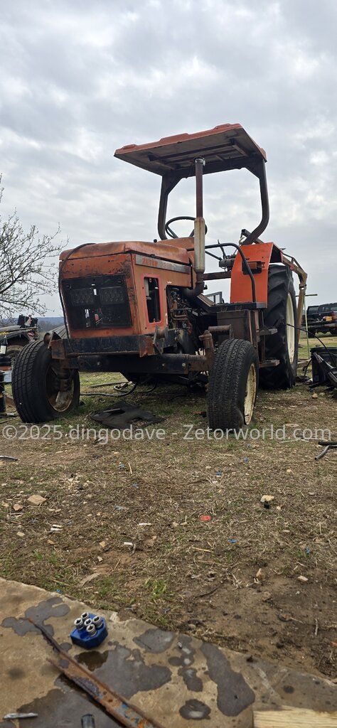

New to zetors and this thing came with chewed up shop rags in the gears and no hydraulic pressure

She's a rough looking character. Has it been idle for long?

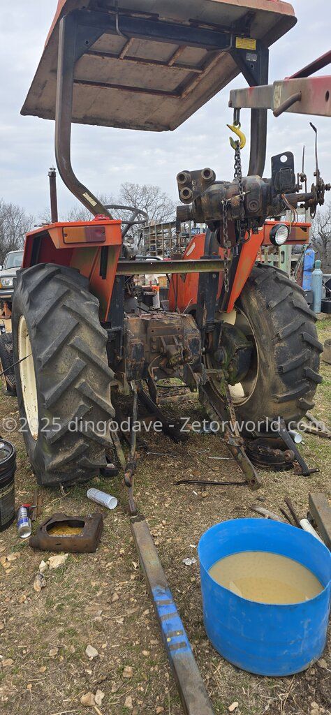

The oil looks very bad... time for new oil after repairing. ;)
Is that what's in the tub? I thought that was something else. Yes if that came out of the backend, it's time for new stuff.
I had a similar oil color back when I bought my Zetor in 2011. While draining it, some of it ran down my sleeve and stank. I almost puked, it smelled so bad. There was water in it, and it hadn't just been there for a few days. Then the oil turns cloudy and eventually starts to stink...

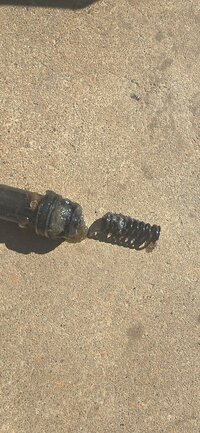

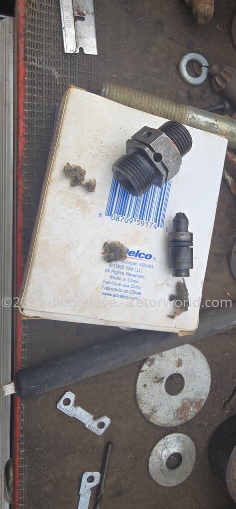

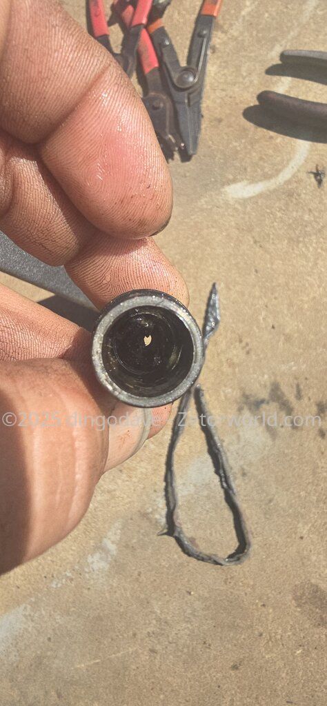

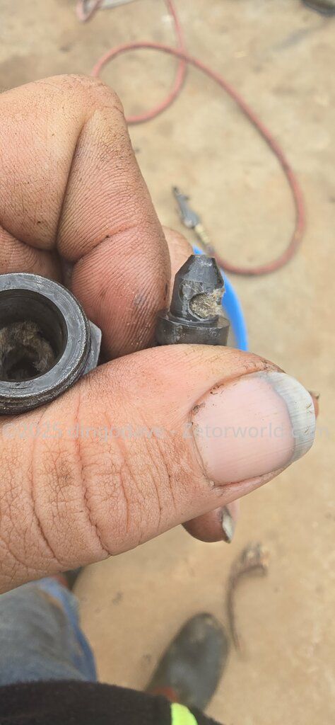

Well We pulled a a lot more shop rag fluff out of the hydraulic distributor, pump, etc resealed everything fresh oil. No luck for hydraulics. 1000005580.jpg

Pretty sure it set for some time like that
