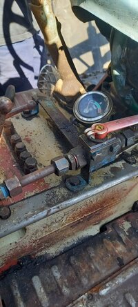

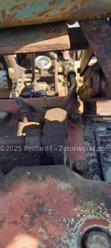

Hello Reidar,
you cab try adjusting the reaction speed lever 3 (the short lever under the seat that can be swiveled). Put it to max or more then the middle.
Lever 2 is on "P" ?
Try also to switch off the loader hydraulic valve - If all the oil goes into the front loader, the hoist cannot lift because the inner circuit has priority.

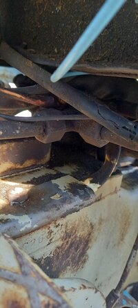

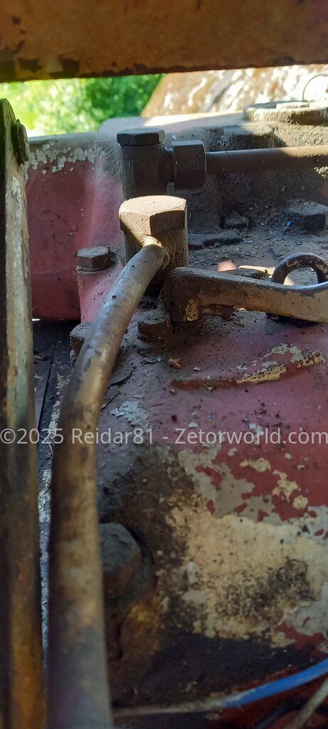

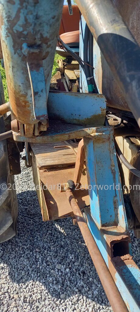

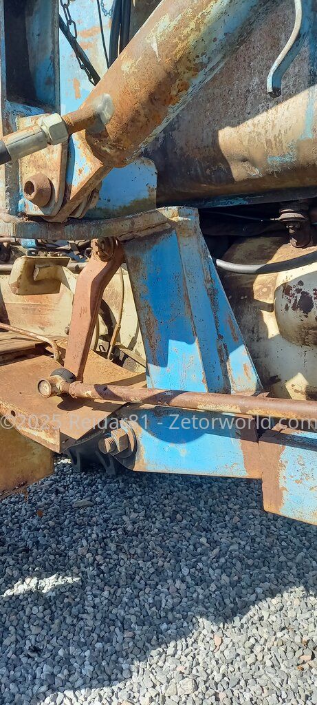

More photos would be helpful so that we can see how your front loader is connected and how the hydraulics are piped. ;)

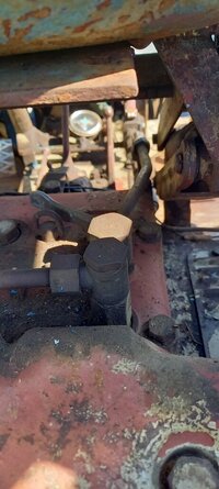

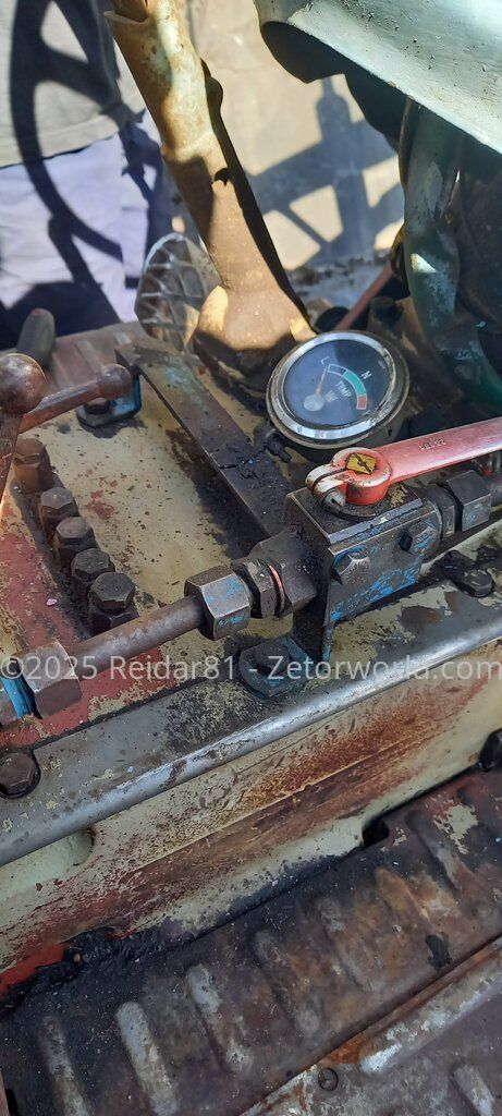

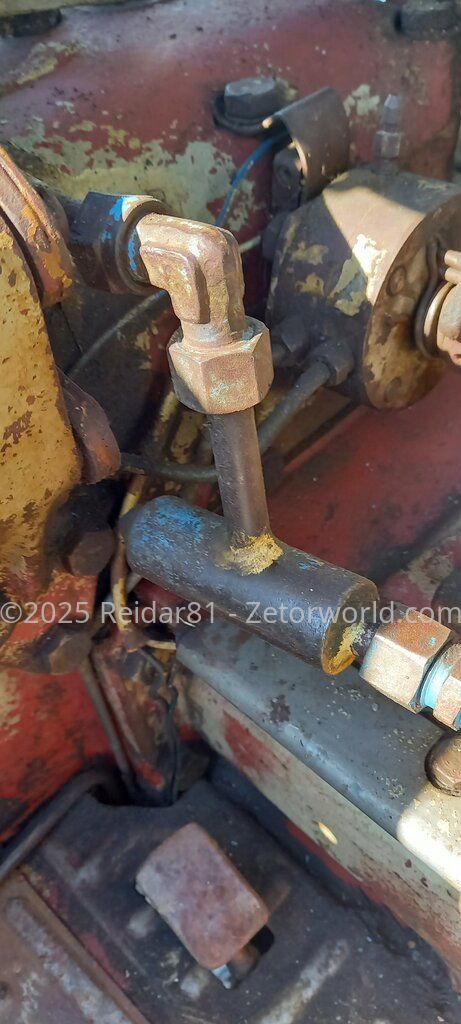

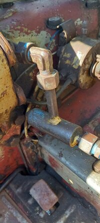

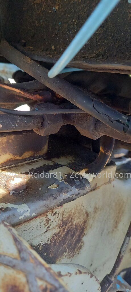

this is how the hydraulic in connected to loader.
20250531_165908.jpg20250531_165918.jpg20250531_170229.jpg20250531_170247.jpg20250531_165938.jpg20250531_165913.jpg20250531_165928.jpg
Ok, ist single pipe direct connection... the easiest way to connect a loader. Should work... hmm... 🤔

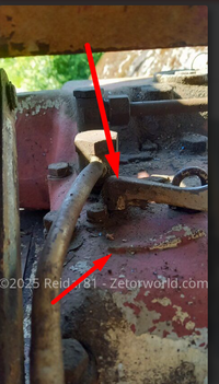

Hit me, but why is the lever moved to min and not to max?
Amd what exactly does that part:
To good last its possible you have to demount the rear hydraulic to take a look inside if there is somthing broken eg.
