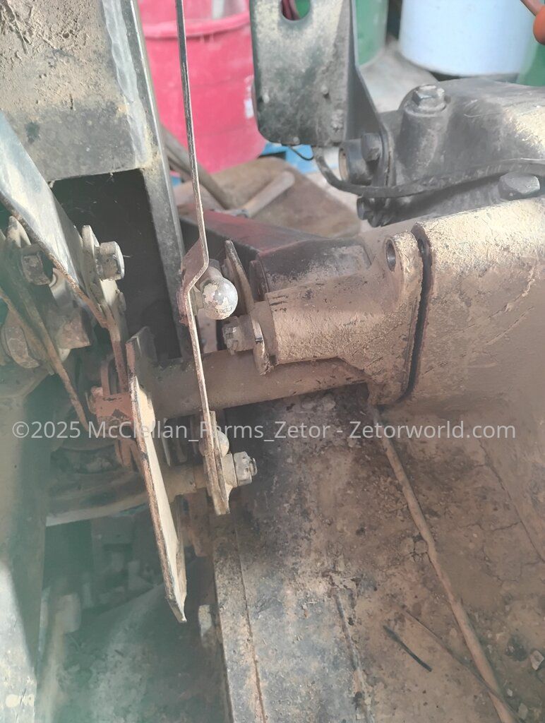

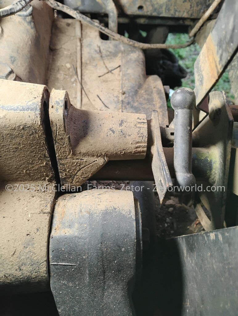

Hello everyone I'm looking for advice!
I have a new to me Zetor 4340 shuttle shift.
The lift lever pin is broke, I have the two bolts out but I need to know what I have to remove to be able to replace this part.
Thank you, Kenny

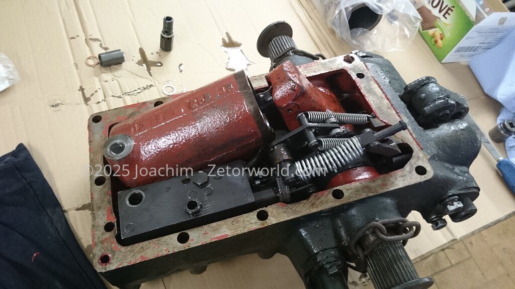

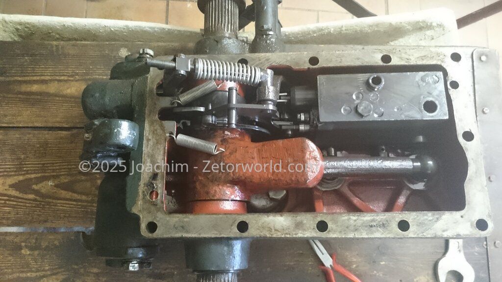

I haven't had to do that with mine yet, but I think you'd have to remove the entire hydraulic system, meaning the top cover with the lifting arms, to get access to it from the inside. And be careful what you do; the Zetormatic's control rods are complicated to adjust if you've misaligned something.
photo is from a Zetor 5011, but look similar at all Zetor UR1 models
Thank you this is exactly what I was wondering about!
