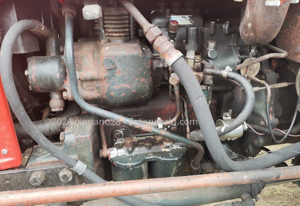

Hello, guys! I have a friend who owns a Zetor 5011. He's not very good with technology, so he asked me to post a question here. At the outlet of the tank, there's a 12v electric fuel pump, and then it goes into the pump with the decanter glass. If he cancels that pump, the tractor doesn't get fueled anymore. Where could the defect be that the former owner installed that electric pump?

I think he had a defective diesel pump and bypassed it with the 12 diesel pump.
Photos would be nice, then we could perhaps say more.

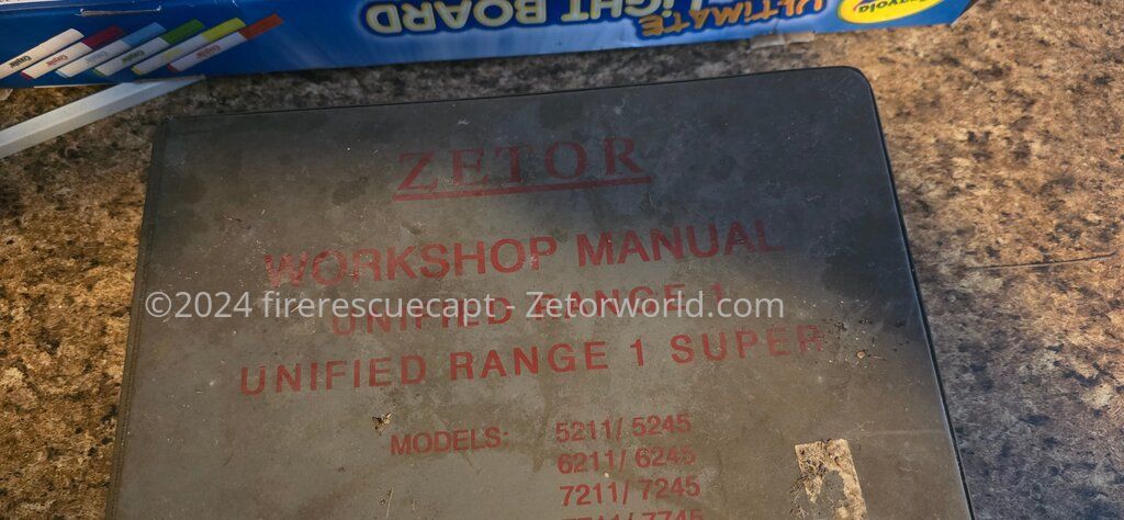

A few years back I added an electric fuel pump to my Zetor 5211. I have the Zetor service manual , and it says (and I am majorly paraphrasing this) that if the pump is no longer able to keep the engine running then an electrical auxiliary fuel pump needs to be added (I can take a photo of that if you want). I think it was Ridgeway that I called, and the guy recommended a Walbro GSL-392 electric pump. I got an off-brand version of the GSL-392 (because the Walbro brand one was not in stock), which fixed the problem. I installed it between the fuel tank and the fuel filter and wired it to the ignition. It has been running well for about 3 years now since I did that. If that electric pump isn't running, the tractor runs for about 3-7 minutes and dies.
Oh please - very interesting. :)

Here you go.
Ok, under the old number I doesnt find a actual electrical fuel pump, but the hint with the min. 10 psi is good. :like
