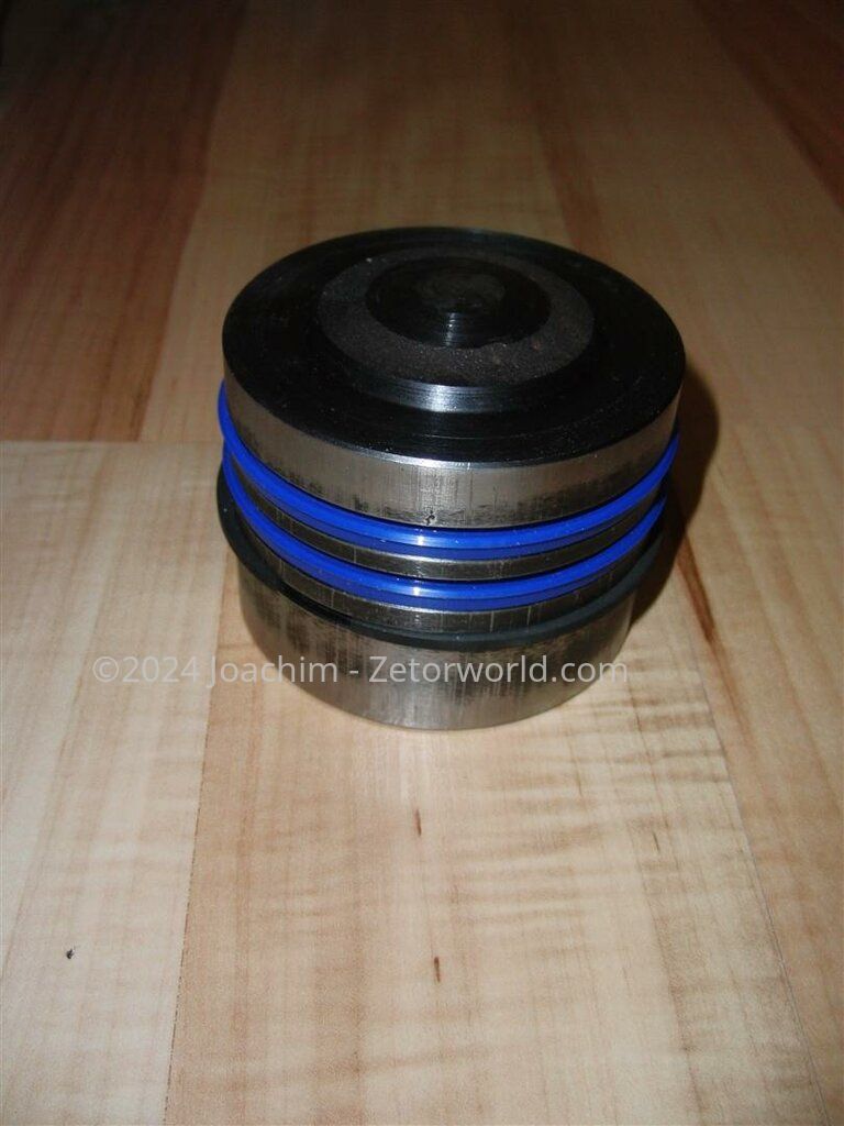

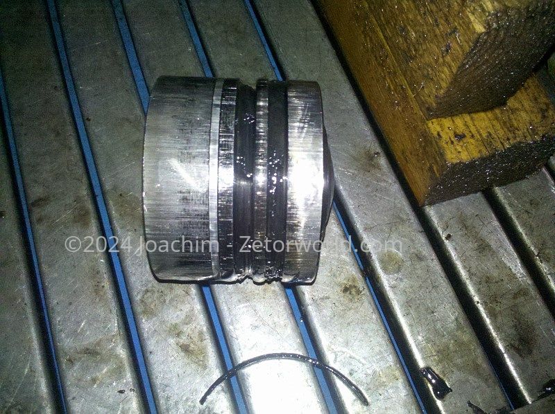

Your hydraulic trouble is in most cases easy to fix - there are just to change some rubber seals at the inner hydraulic cylinder + a new paper seal and 2 new rubber (silicon) and copper seal rings. Not a big thing.
But... if that problem exists a longer time, then it can be its more to change like the complete hydraulic cylinder.
You have first to open it, take a look at the parts and then change the damaged ones. :)

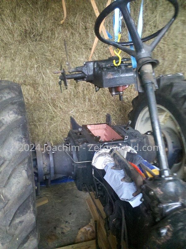

  • Remove the handbrake cable and PTO cable
  • Remove the hydraulic lever console
  • Remove the rear lower window with the metal frame
  • Unscrew the rear lower floor panel and then tilt it forwards towards the steering wheel with the seat on it and support it

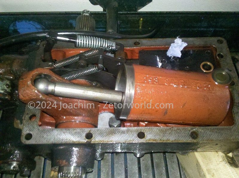

Then you can get to it from behind with a workshop crane and remove the heavy cover with the hydraulics. Not complicated, but a lot of work. ;)
I had dismantled the cabin for other reasons (rust and welding as well as new paint ;) )
Heckkraftheber_deckel_02.jpg Heckkraftheber_kolben_alt_01.jpg Heckkraftheber_kolben_neu_01.jpg
