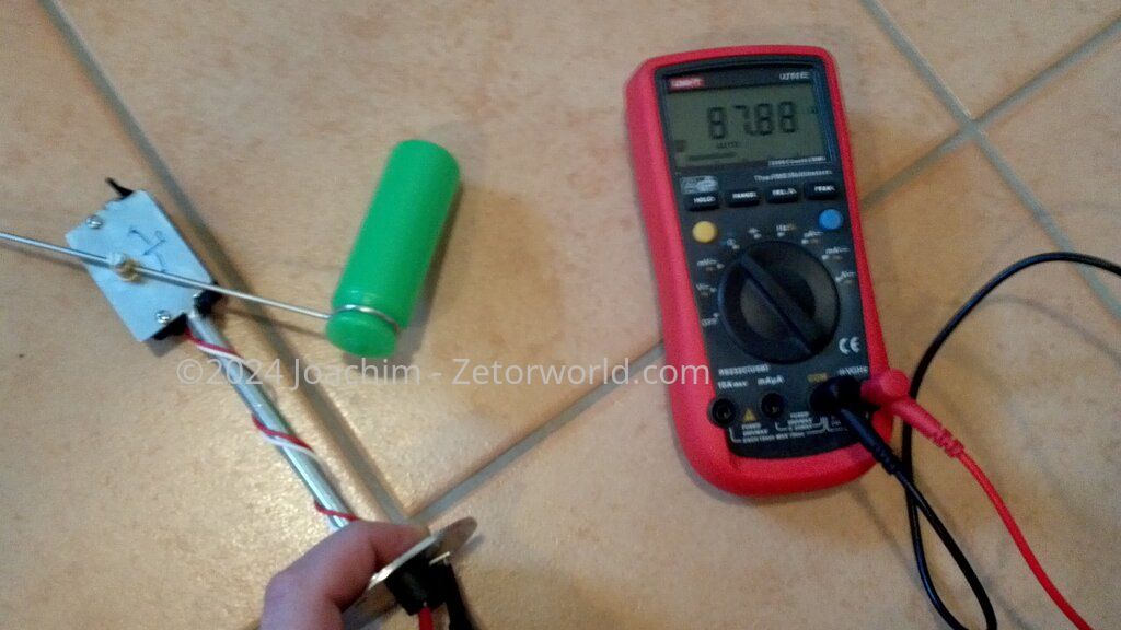

You can also use other fuel senders, with the same srew sheme and with a messure range from around 0 to 90 Ohm
Dip tube sensors (ø 54 mm) are even better and you have a smoother fuel gauge (needle doesn't swing as much) - eg from VDO:
One hint in this case...
The original swiming sensor: (ø 54 mm) and 60 mm instrument
empty tank = araound 2 Ω and full tank araound 80-90 Ω
Dip tube sensor: (ø 54 mm) and 60 mm instrument
empty tank = araound 70-80 0 Ω and full tank araound 2,5 Ω
That means without the VDO instrument for a dip tube sensor, the instrument display shows exactly the opposite. ;)
So there are three solutions for this:
  1. ignore them ;)
  2. or buy also a VDO instrument for a dip tube sensor
  3. or buy also a tool like this: :like

    Its a KUS Resistor changer with adjustment for min and max level (cost around 22 Euros)
    eg. KUS Ohmwandler Widerstandswandler Widerstandstauscher Umwandler 0-190/240-33 Ohm | eBay - https://www.ebay.de/itm/285931920884
