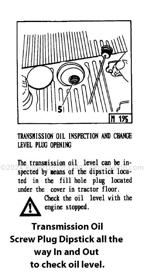

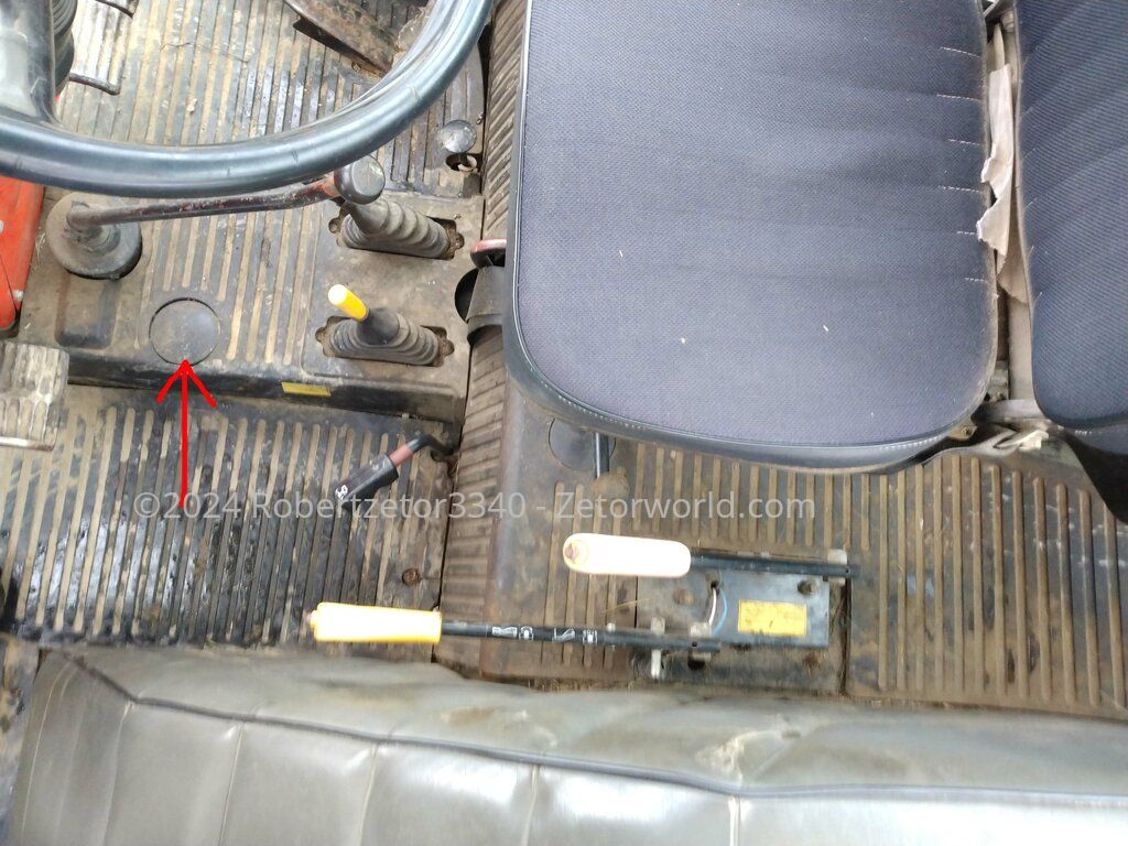

Where do you check the hydraulic fluid level? Hadn't seen a dip stick and hadn't seen it in the book I got with it..I'm sure I'm just overlooking it somehow..

But, regarding the oil stick, it's usually at the driver's floor, between the gear shifting stick and the PTO switch/lever. It's probably just like the head of a very big thread/screw, so that you can easily turn it counter-clock wise to be able to pull it out and both check the oil level and complete it when necessary.
