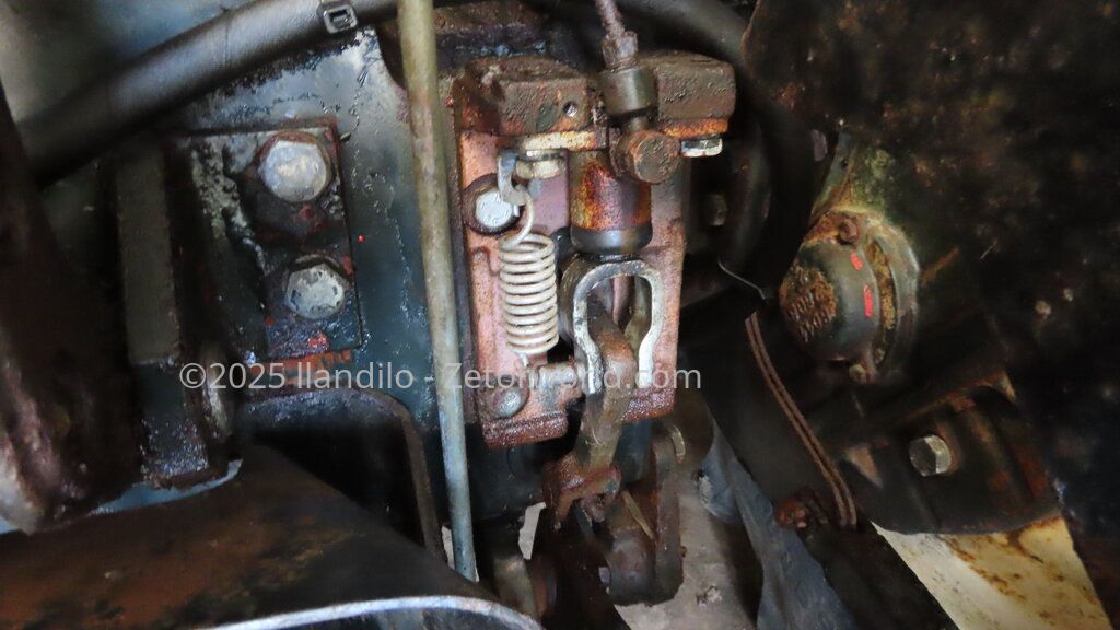

Hello, I have two black plastic boxes on the back of my tractor which as I understand it denotes it is fitted with rear disc brakes. I have been trying to find the brake fluid bleed points and have read that it should be in this area but I can not find them (see picture). Will appreciate it if anyone can explain where the brake fluid bleed points may be.
RobertView attachment 2699
There should be a bleed nipple beside the cylinder

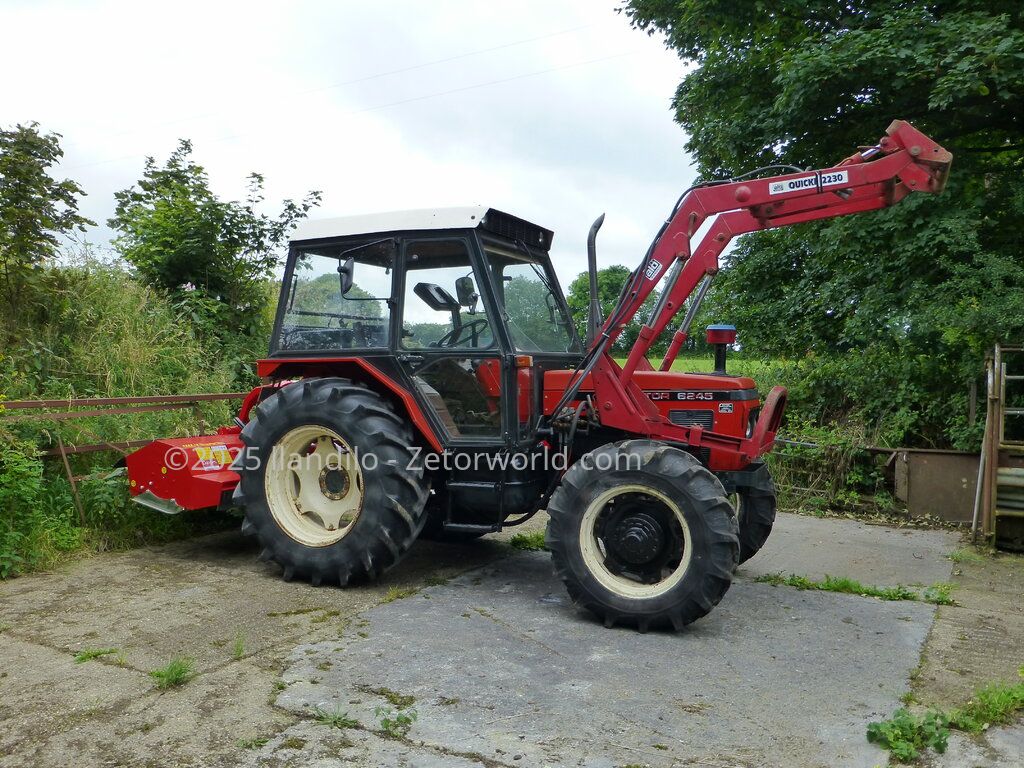

Sure you have a Zetor 6245? I know not one Zetor 6245 with disc brakes.
Dry disc brakes I know only from 7711, 7745 and Turbo as 3320 to 7340 Turbo - so Iam a little bit confused....
hmm... looks like a 6245.
Maybe a some one switched the gearbox, as disc brakes comes in one with 30 kmh instead 25 kmh. :unsure:

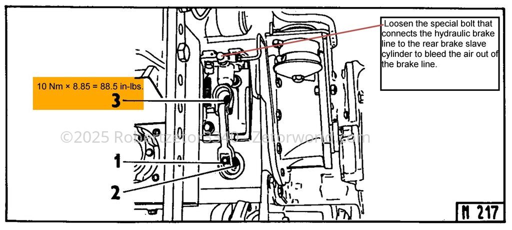

I believe you can do it this way if the is no bleeder or the bleeder is to rusted up to break free.
Click on picture to expand it.
Also ask Joachim if he has the part number and a picture of the rear brake slave cylinder for your tractor.
Could your tractor be a 6340 ?
