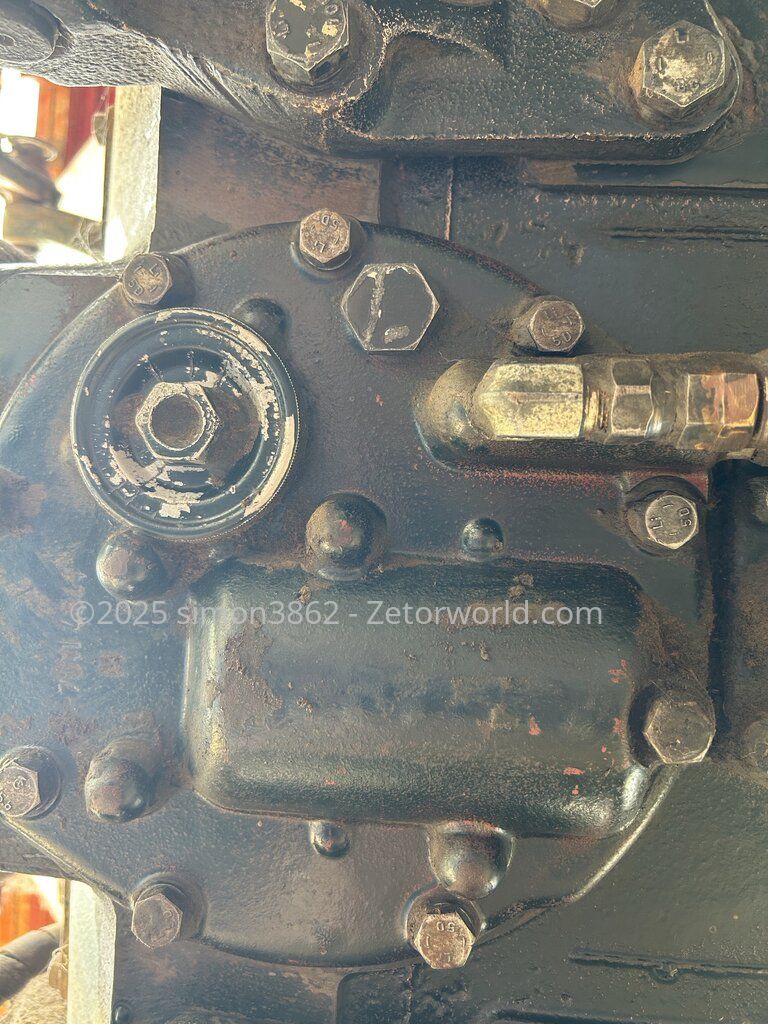

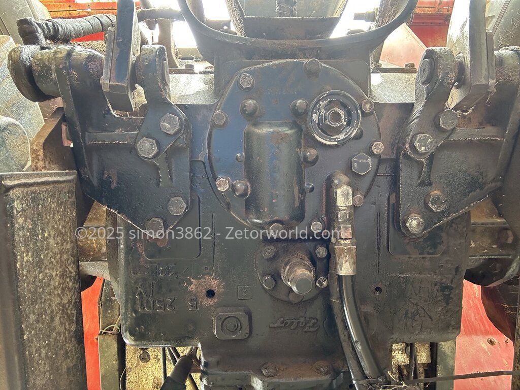

Have you possibly adjusted the reaction speed lever?
The short one at the front of the hydraulic console, which you can swing left and right.
If it moves very easily, the rod under the cabin may have fallen off, then take a look there too.
See also handbook hydraulic instructions section - its explained there.
