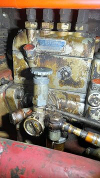

Can anyone please tell me what size are required for the replacement o rings, i tried standard ones from stock which have made it leak even more !
Thats only possible when you can say what type you have mounted or bette a picture from. I know around 6 types from. ;)

Ok, ist the original one from Motorpal.
2 = 14x20 Alu sealing
6 = 11x2 NBR o-ring
7 = 14x3 NBR o-ring
Hope that will help you.
