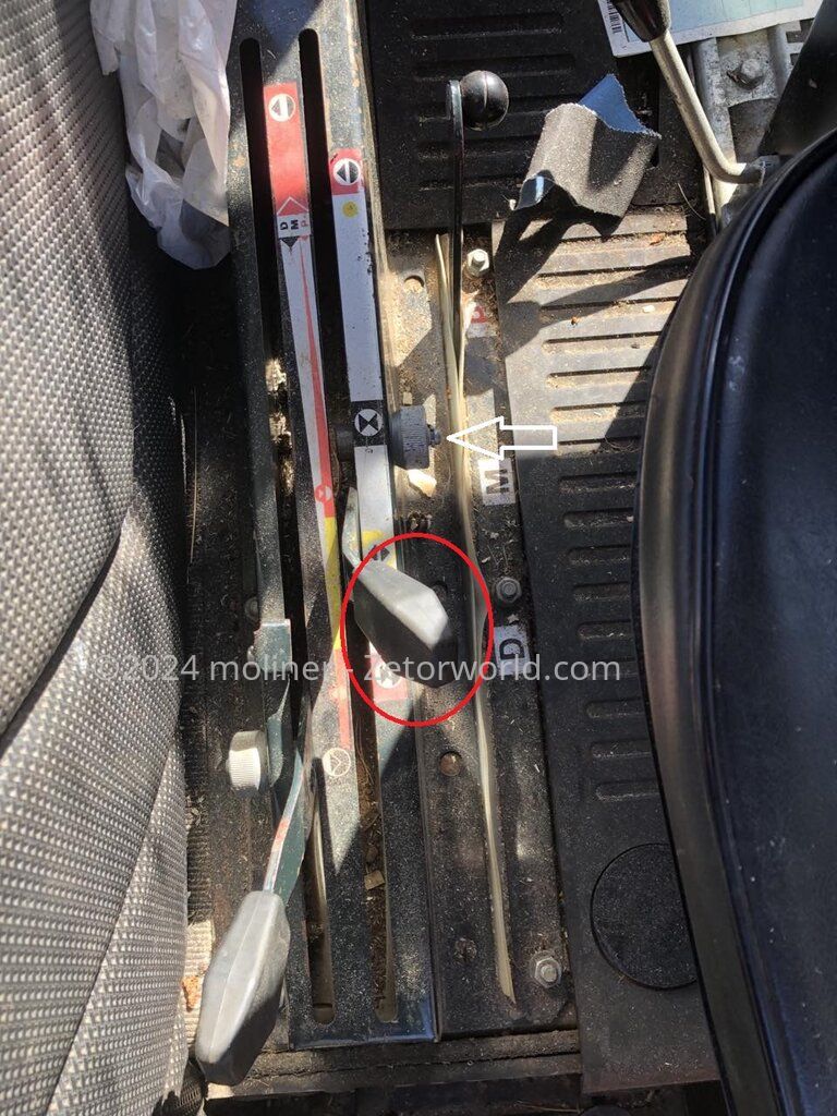

Hi Will,
yes this is normal. There is a "locking wheel" you can use to lock that leaver in the forward position.
You don't need PTO engaged though. There is a position for hydraulic pump only, but maybe that's where you are :) ?
Attached picture is from a newer model, but this is just to show that "locking wheel" (white arrow)
