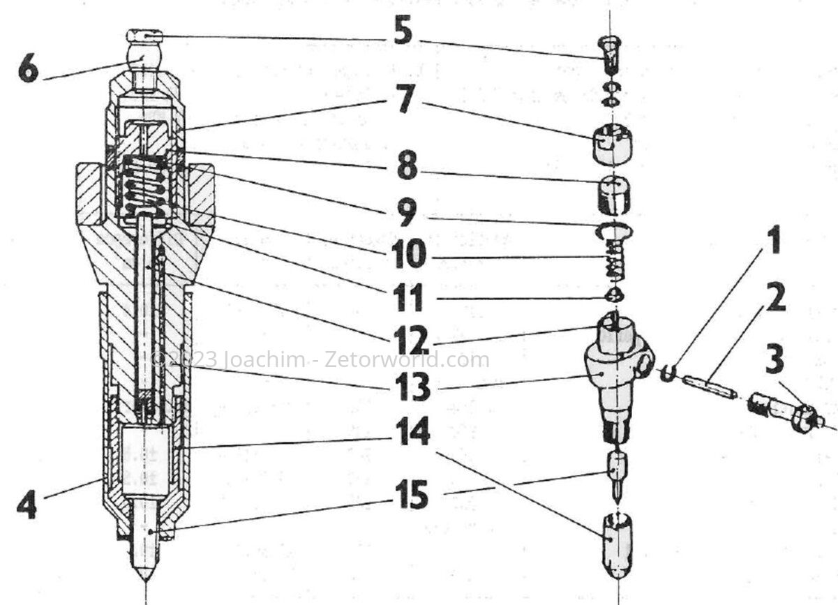

Can anyone tell me if there are supposed to be copper washers on the injectors of a Zetor 7011
No no copper wahsers - its a bad idea.
Better is number 95-0503 - its a 10x18x0,15 to 0,3 mm aluminum washer.
