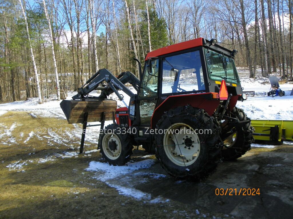

Hi Everyone,

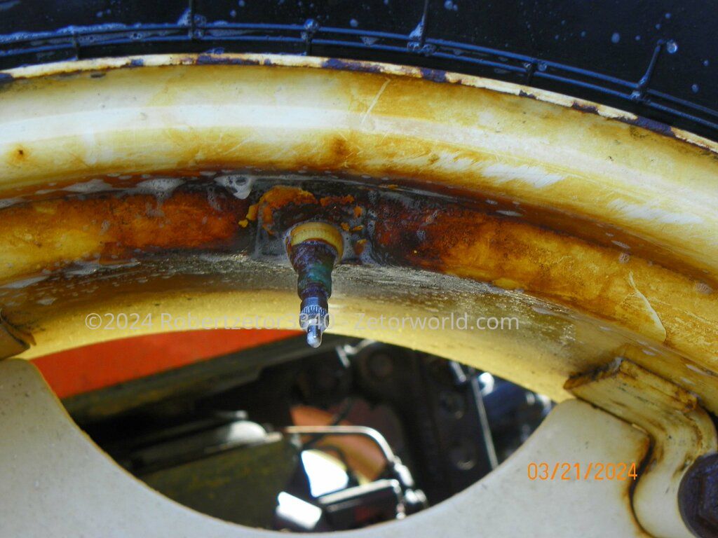

My Zetor 3340 left rear tire valve-stem was leaking a liquid from around the cap by drips.
My first thought was the valve in the stem may be old and need a little tightening.
The wheel was stopped where the valve-stem was at the bottom
and I as soon as the cap was rotated to its last thread, the cap disappeared and
spaying tractor tire fluid 10 feet into the air and about 10 feet out.
Yes, I got spayed too.
I put my finger over the valve-stem which stopped the explosive spaying,
but I had no cap to place on the spaying valve-stem.
I have spare valve-stem caps and so had to leave it to get one, which did return it back to its slow dripping.

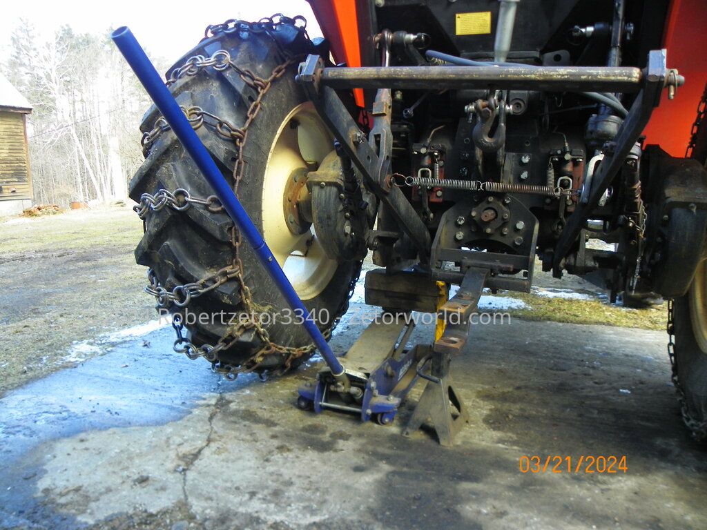

Next, I started the 3340 up and drove ahead until the valve-stem was at the top of the wheel and jacked up the wheel off the ground.
I got the tools I would need with a new valve for this valve-stem.
When I removed the cap there was a lot less spaying and there was no valve to be seen.
When I tried to install the new valve in, it would not install all the way and I am not sure what is going on here at this point.

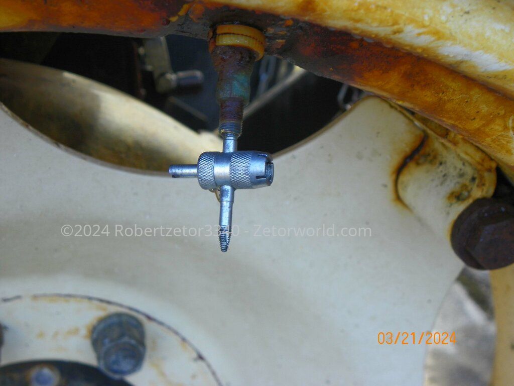

I have a valve-stem tool with me and it did thread into the stem and stopped the leak.
The tire has lost a fair amount of air and tractor tire fluid, so will need to be re-inflated to it proper PSI.

Past that little difference of (kPa), I do have a few metal valve-stem caps and using a rubber tipped air-nozzle then filled the tire to its proper PSI.
Next I attached the metal valve-stem cap and now it is not leaking.
Thinking about this old valve-stem, it may have a broke off valve in the stem.
I maybe able to drill out what ever it is in there and install a new valve into this stem,
but that is for another day.
