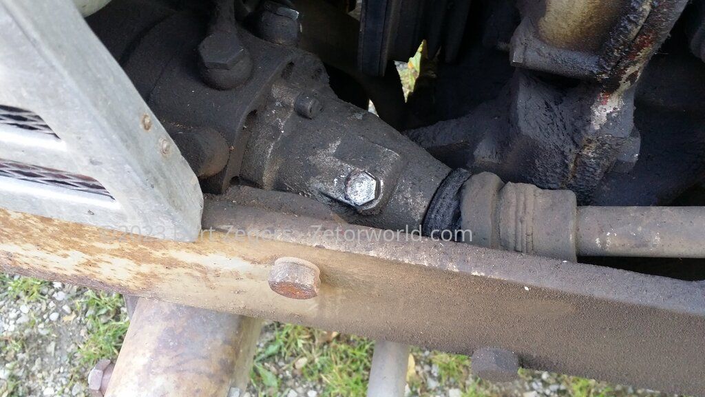

The steering on my 8011 has a plug that looks to me as a fill plug. There is no oil in it. I cannot find any info in the owners manual .
Should there be oil in there, and what kind ? (The reservoir has 8 liter ATF/automatic transmission fluid in it and the steering assist still works good)
