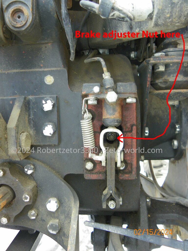

Pulled off the road and waited for it to cool down and then adjusted that brake,
Had to back it off a lot.
This is done at the back of the tractor (See picture).
You may need to remove a black cover first and then you should see where the adjustment nut is.
See / Find the black nut and make it looser by backing it off.

This picture may be a better help

How to adjust brakes on rear axle?
For a "Hello, Iam Harald. And this are my Zetor tractors... + *a photo from tractors*" Iam be willing to copy some stuff from Proxima workshop manual . :) ;)
There's also that adjustment on the brake pedal itself, but I believe it's less often that the problem is there.
At least the real problem was on the pedal's adjustments in my case, when the rear-left brake began to lock by itself, "out of nowhere". Initially, at least... :cautious:
