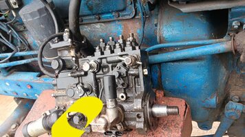

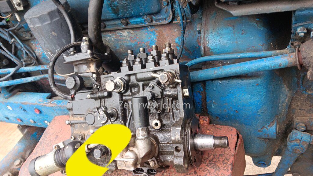

I have a Zetor Proxima Power 120 hp .
The injection pump must be changed and i don't know how to mount it .
Timing pukp and timing engine tco.

Put No.1 cylinder at TDC on compression stroke. (Valves on No.4 rocking) put pin in flywheel hole.
Take cap off side of pump and remove spring. Put pin back in and turn pump to find hole to lock pump. Fit to engine and torque up nut on front.

I found a video of the pump where it gets stuck.
The engine is pulled on piston 1 in compression . The valves are closed and the piston is up.
I'll check the flywheel for that stuck hole.
Is piston 1 marked from the front of the radiator or from the back of the flywheel?
