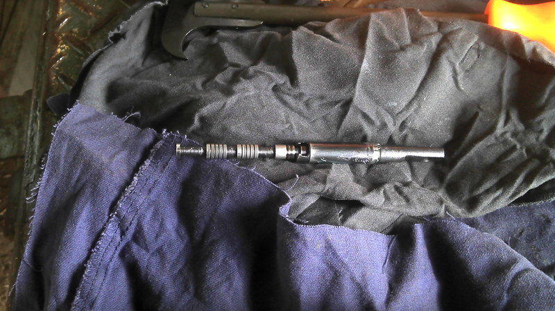

Can anyone that has had thier hydraulic distributor apart recently varifyed that the inner circuit spool valve from my 6245 in the picture below is assembled correctly? I am having trouble with my 3pl and as best as I can tell from the workshop manual and parts book, that is correct but I am not 100% sure.
Paul.
I'm trying to think back to when I had mine apart about 12 months ago, I have a suspicion it goes the other way around, but I could be wrong too!
Is the spring fitted inside the two halves?
What is the actual problem you are having with the linkage?
Yes there is a spring between the two halves.
