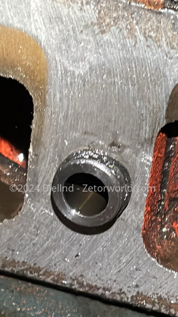

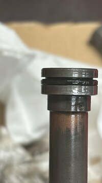

An often coming damage on older Zetor models with low oil pressure will be only a damaged rubber seal:
It is often enough to bend the pipe 32 a little so that it sits a little deeper in the blind hole with the sealing ring 33 and to put in a new sealing ring 33. It is best to have one with an oversize (originally it is 18x2 mm - better is 18x2.3 mm with a thicker cord) and made of Viton or silicone instead of NBR (which was originally installed at the factory).
When fitting the pipe 32, make sure that you do not pull it out of the blind hole when tightening the pipe. This is a somewhat unsightly construction in this place, but if you pay attention, it is not a problem.

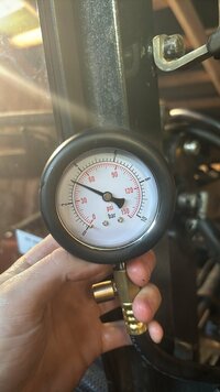

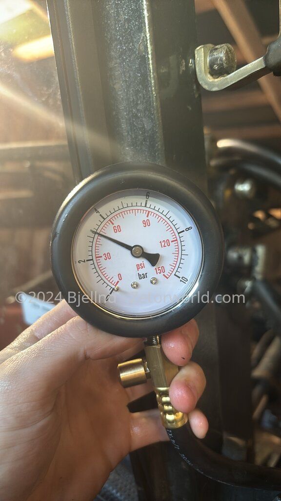

at engine temp 80-100 I get 3 bar at 1000 rpm. (The second the cooling water hit 100°) It moves with the rpm somewhat. “Max” is getting lower and lower.
Have been idling for an hour, but I can’t get the pressure above 2,2 bar

Ok, then look at the rubber sealing I wrote.

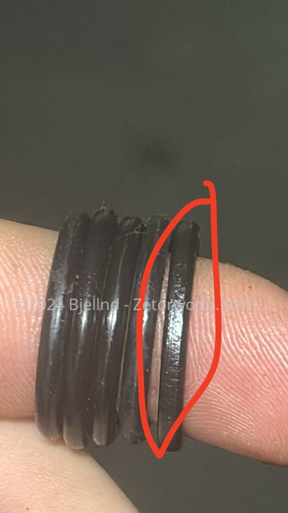

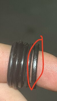

The oring on the right is the one you were suggesting that was bad. It’s crusty and very “hard”
typical for many years old NBR rubber - replace it with a viton or silicon seal with 0,3 mm more and have fun with a great again oil pressure. ;)
