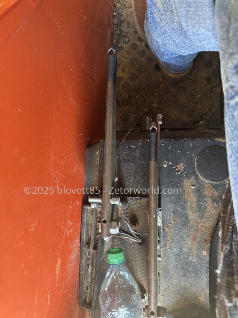

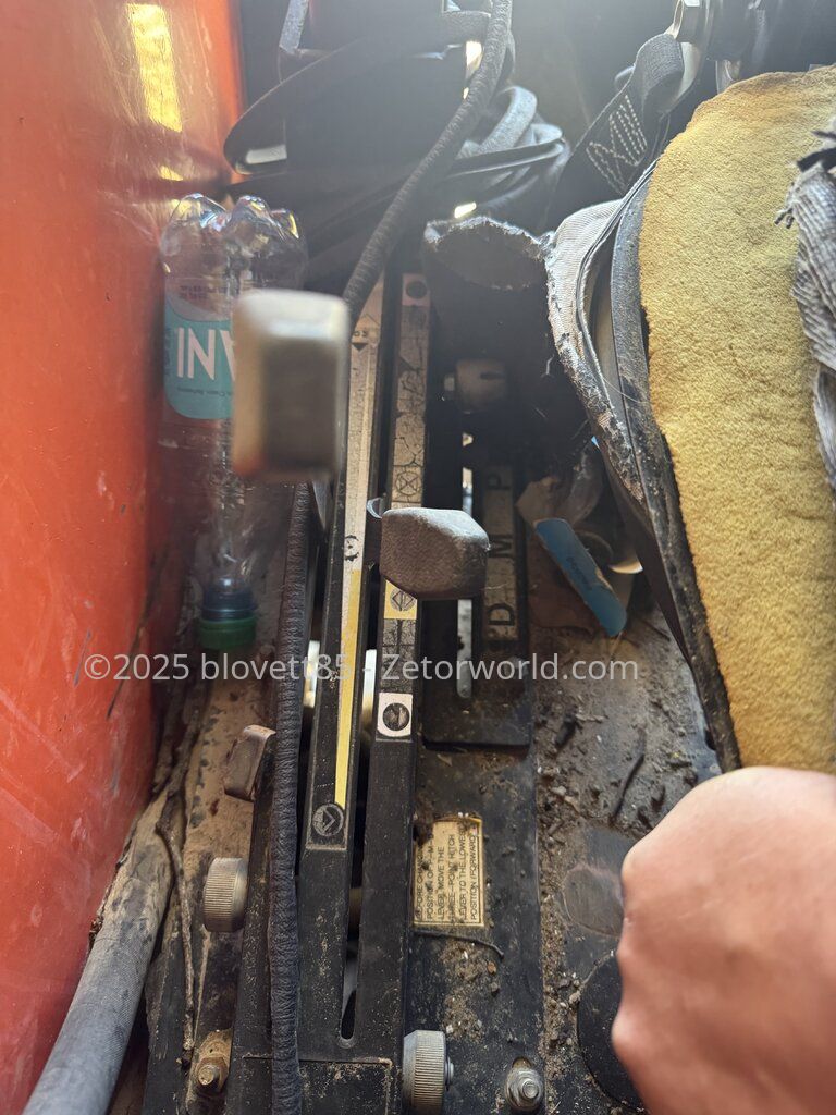

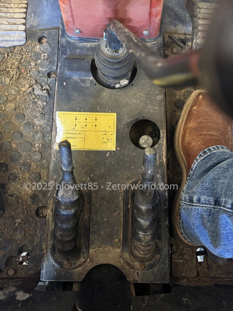

How do I engage the PTO on my Zetor . With the engine running when I try to engage the PTO lever forward it just grinds and I have to shut it off. It goes forward fine with engine off.

Hello. You need to pull up the hand clutch on your type tractor before you try engage the lever on the floor. The hand clutch is in your second photo, on your left side as your sitting, it looks like the hand brake but closest to you.

It's the left lever on your picture, and the different settings is shown on the yellow sticker (left side).
Remember to first pull up the PTO hand clutch on the left side of your seat, then move the left lever on the floor to the correct position and lower the PTO hand clutch.
Hello Brian,
as @diyfarmer says, you need to pull up the hand clutch before operating the lever on the floor.
However, when looking at you second picture, it looks like your hand clutch lever might be broken? (push button/rod is hanging on the outside of the lever)
Hi blovett85,
Your Levers are missing the colored plastic handles.
When sitting in your tractor seat, the two levers to your left, I believe:
First Lever (should be Red) is shorter in length, is the parking brake,
Second Lever (should be Yellow) is longer in length, is the PTO Hand Clutch.
The two black Levers on the floor between your legs behind the gear shift lever,
I am not sure about them because they both have black colored handles,
but I lean toward them being for selecting the PTO options.
You may have a two-speed PTO system, which one of these two levers may be used to select between the two PTO speeds.

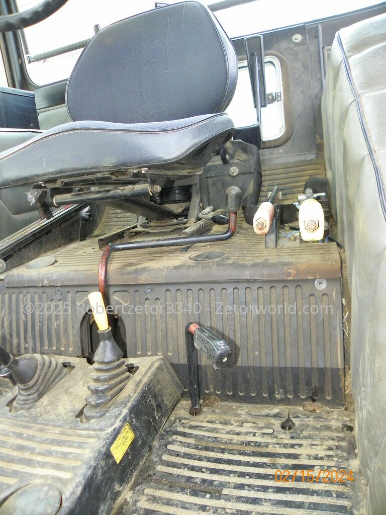

My two Levers on the floor between my legs behind the gear shift lever, the one to the left (Yellow) is for PTO selections.
The one to the right (Black) is for the High and Low speed range selection.
My 3340 Zetor is a 4WD and only has the single PTO speed system with the Shuttle-Shift transmission.
Also I have the High and Low range lever (see my picture up at the second posting).
I hope this info is a help for you.
