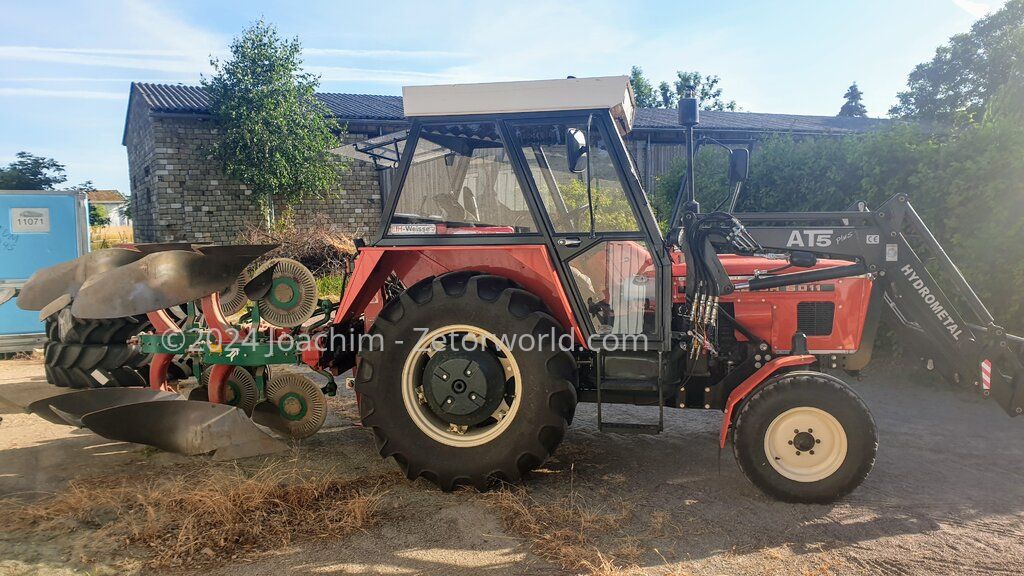

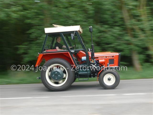

16.9-28 looks like this (its my Zetor 5011, with 420/85R28 / 16.9-28 at rear axle and 7.50-16 at front:
Its OK for me and better than the former used 12.4-32 tyres on my Zetor 5011 ;)

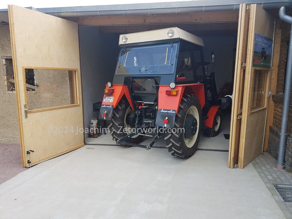

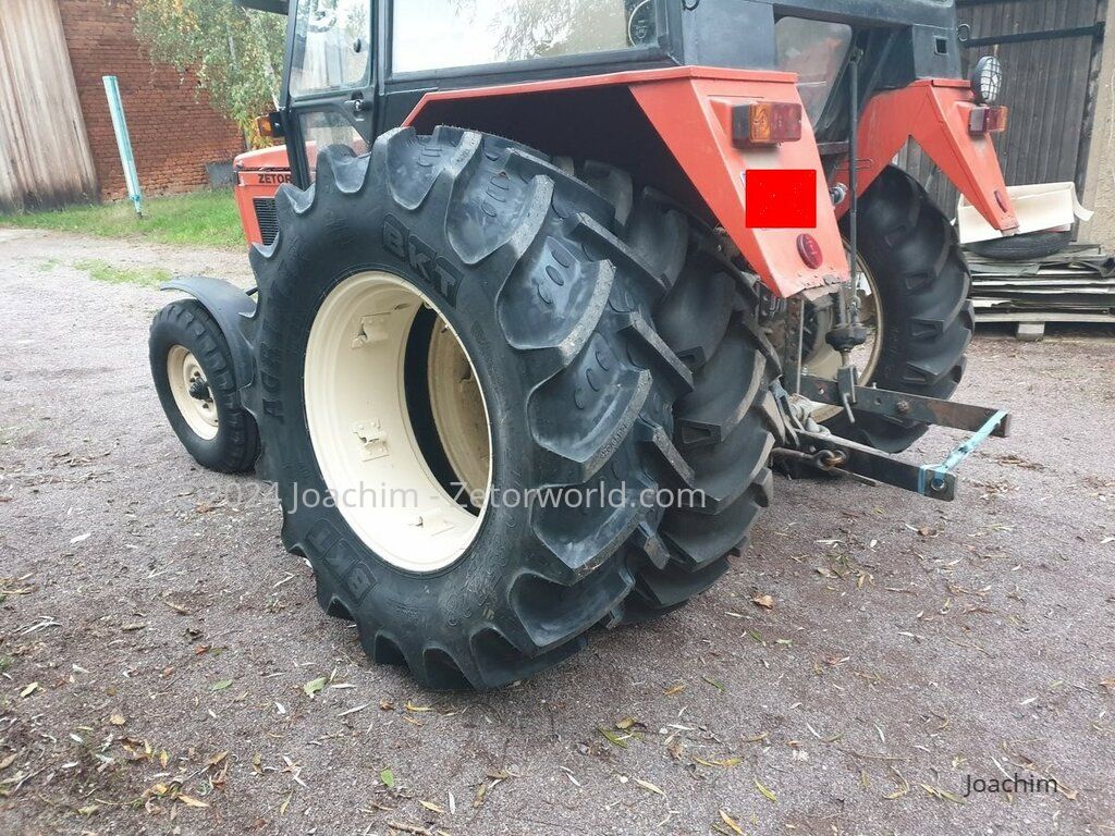

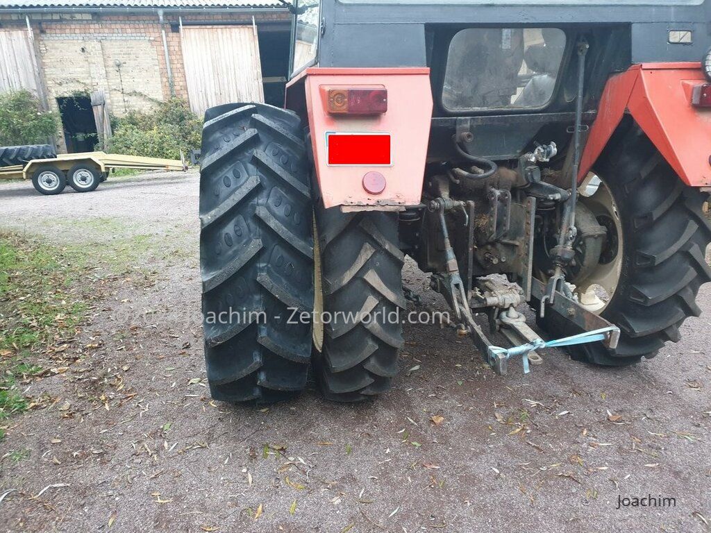

comparsation from behind - 16.9-28 vs 12.4-32
