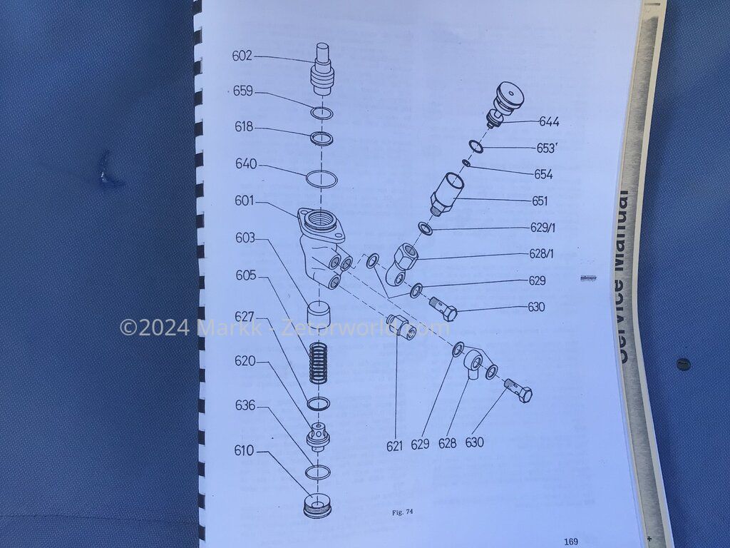

Park the tractor two days ago will not start. Will run with a little bit with either change fuel filter blew out line from tank to the
priming pump can’t seem to get a priming in it. Any ideas? Thank you.

If not - please check the valve in the fuel feed pump behind the large slotted screw. Remove, clean, reinstall.
If the feed piston in the fuel feed pump moves easily and has no grooves/scores, the filters are not clogged, the injection pump is not defective (regulator is stuck) then it should work.
Thanks for your reply Can you tell me what valve behind what screw For the fuel pump I’m not sure what regulator you’re talking about? Stuck thanks I appreciate it
