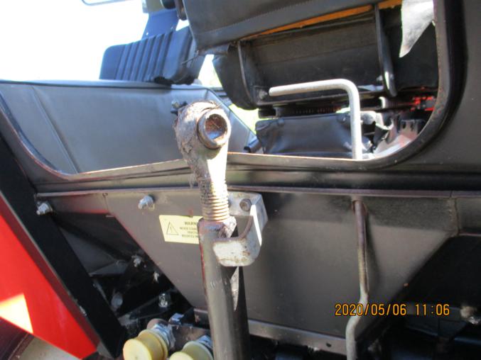

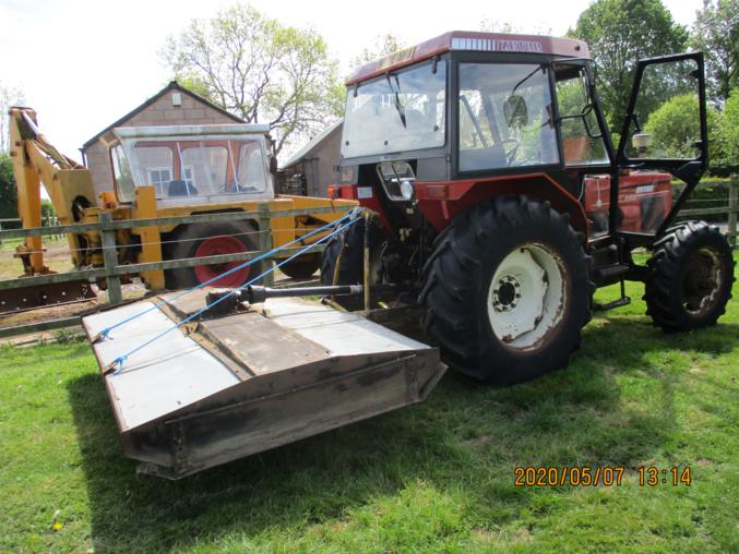

As my 6718 came to end of life, I have bought a 5340, having fitted my Twose 9 feet topper to it found the upper tie bar, which is in the bottom of the 4 holes, comes up and hits the small window knocking it out and bending window frame. Have straightened frame and put window back.
Should the upper tie bar come back that far? Is there any way to restrict the lift up position, there is a stop for down.

You were pure lucky the window didn't shatter. One thing I notice from the second picture is the toplink fitting is very high on your topper and as you raise it, it's getting too close to the window, you'll just have to be more careful not to lift it up to the last from now on.
You could fit a restrictor to the handle in the cab so you can't move it all the way to the top.

Can you only lift that topper so high anyway, till the pto shaft start rubbing off the topper body? I seen ones like that topper before with the pto cover shredded from rubbing off the frame when lifted too high when it's running.
Never lift it with pto running, it does lift quite high because the toplink fitting is very high. which pulls the back up higher than the front, keeping shaft clear of topper frame.

Have fitted a piece metal in the slot to stop lever going back further when lifting topper.
