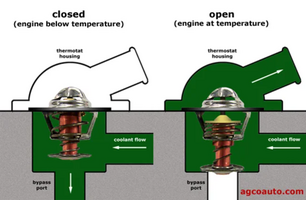

Whether yours 4 bolts or 3 I said makes no difference, the same principal applies, the thermostat is in the housing and be careful opening the bolts or they'll ring off. The thermostat is just sitting in but maybe stuck, the sensor end goes down. Maybe able to check it a bucket of boiling water it should pop open. Have look at this picture https://www.benzworld.org/attachments/engine_thermostat_flow_open_closed-jpg.500778/
