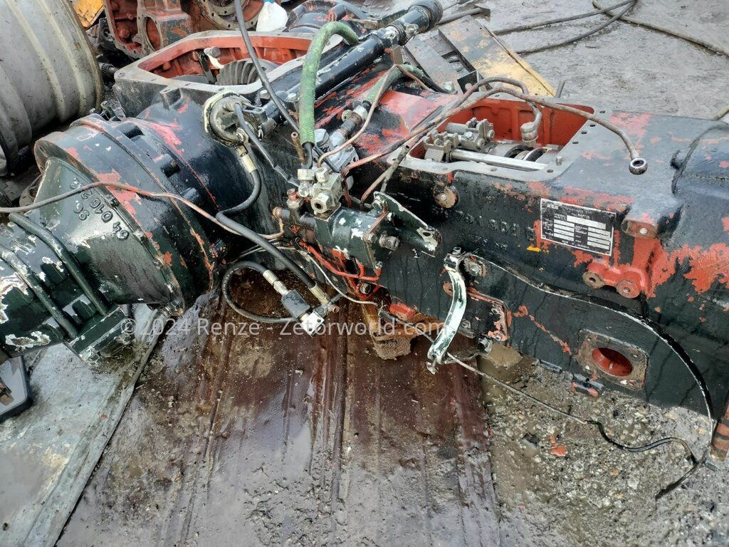

Someone in Poland searching parts for first generation prototype of this 4 speed powershift gearbox:
Ogłoszenia - Sprzedam, kupię na OLX.pl - https://www.olx.pl/d/oferta/skrzynia-biegow-zts-zetor-18345-power-shift-4stopniowy-CID757-IDXdrhE.html
On a gearbox plate is
ZTS Výskumno-vývojový ústav Martin, a.s.
TYP DP135.1 63.901.753
P1 136kW
M1 780Nm
G 530 kg
VYR. C. 03.98 (month.year)

ZTS 18345 with second generation prototype 4 speed powershift gearbox:

See that, this 18345 rear axle has SUBSTANTIALLY bigger planetaries and crown gear. Thats good because even at 140hp the UR2 axle would break the pinion shaft out of the housing.
