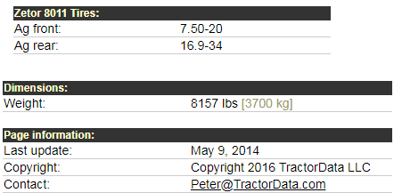

THE 8011 WEIGHT,
8011.png,optional_width,optional_height

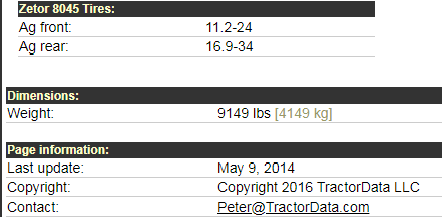

THE 8045 WEIGHT,
8045.png,optional_width,optional_height

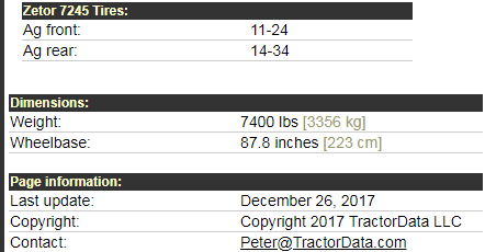

THE 7245 WEIGHT,
7245.png,optional_width,optional_height

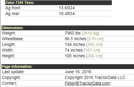

THE 7341 WEIGHT,
7341.png,optional_width,optional_height

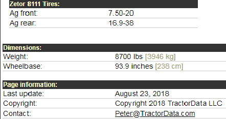

AND LAST THE 8111 WEIGHT,
8111.png,optional_width,optional_height
Are those specs the right ones?
